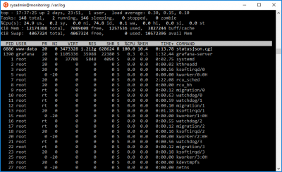

consulvation wrote:I had top running when I clicked on the Nagios Service Problems link on the left. It took 1m 15s to load the page.
Can you do this again and after a few seconds of waiting take a screen capture of the top window?

by consulvation
Here you go...
Top
Top
Re: Nagios process at 100% CPU, system is crawling
Posted: Tue Jul 31, 2018 8:09 am
by scottwilkerson
Looks like the load has come down considerably, and the nagios process is not in the list of top processes.
The one item listed is a call the the statusjson.cgi which can be intensive if the call is for historical data

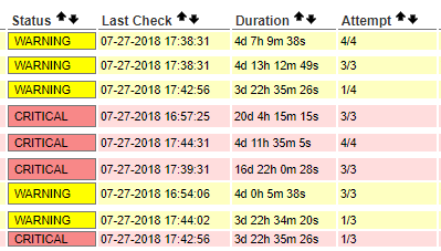

Also, I should add that it looks like Nagios is stuck in the past. Looking at the status, the last checks were from 4 days ago. Looking at the scheduling queue, it's from 4 days ago.

consulvation wrote:Also, I should add that it looks like Nagios is stuck in the past. Looking at the status, the last checks were from 4 days ago. Looking at the scheduling queue, it's from 4 days ago.
Is this resolved as well?

It seems to be fine so far. The status.dat and retention.dat files seem to be holding in the 800-900K realm, I will continue to see if it increases significantly. I am still running the maint version, just not as a deamon.
Yes, once I renamed the super large status and retention.dat files, it became current and all host checks are being done, notifications are working again as well.
