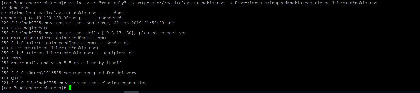

Ive tried above command to send email, see screenshot photo, and it works fine without any error.mayuril wrote:This is an all-in-one command that sends email to $TO_EMAIL_ADDRESS . You need to also replace these $FROM_EMAIL_ADDRESS and $FRIENDLY_NAME variables with your email and name.
$ mailx -v -s "$EMAIL_SUBJECT" \
-S smtp=smtp://smtp.ust.hk \
-S from="$FROM_EMAIL_ADDRESS($FRIENDLY_NAME)" \
$TO_EMAIL_ADDRESS
mailx will read the email content from STDIN. Type in the email main content and input “Ctrl+d” to tell mailx you have finished the content. The mail will be sent out. You can also use pipes like:
The problem that Im facing right now is the client within linuxhosts.cfg file, I did some testing by shutting down one of the host (rancid) I expect to send an email notification to the email Ive setup within commands.cfg, but it didnt work.
