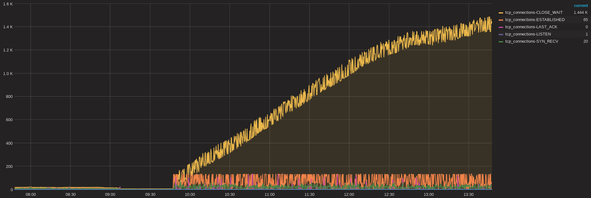

Are you able to lab up another machine and reproduce this? I'd like to get another strace while a tcpdump is running as well, and run these both for a bit while the netstat output is monitored so we can focus on specific ports and connections to look for. Doing so on the current machine will likely result in files too large to analyze.

It is possible to create vagrant VM with identical environment for Nagios server and 2 aditional VM (one with NSCA client v2.7 and one with NSCA client v2.9). Next i can run suggested commands:
tcpdump -s 0 -i any port 5667 -w output.pcap
on each VMs.
Do you mean this procedure?

Yes, except I would be mainly interested in seeing just an environment with a 2.9 client for now. And I would also want to get another strace at the same time the new tcpdump was running:

Hello.
Added requested files to my GoogleDrive, have prefix dev_.
Server IP is 172.17.1.23 and clients IP is 172.17.1.161 (NSCA v2.7), 172.17.1.11 (NSCA v2.9). TCPDump is from server and client with v2.9. Each VM are CentOS7.
In this setup i dont spot any opened CLOSE_WAIT connections. It seems, that this occured only when many servers send reports. Or, should be closed by kernel and we cannot spot it, because in this setup is too small count of total checks. Hope that helps.
Is there anything else, what can i do for you?
Thank you for your effort.

Unfortunately the data doesn't tell us much if the issue wasn't reproduced. The process is running as nagios, so let's switch to the nagios user and get the ulimit output:
su - nagios
ulimit -a
I'd also like to get copies of /etc/security/limits.conf and /etc/security/limits.d/90-nproc.conf

Hello.
cdienger wrote:Unfortunately the data doesn't tell us much if the issue wasn't reproduced.
Yes, i know. This is reason, why i ask for support and send statistics from production environment. In development environment i not spot any problems. It seems, that this problem occured, when more like ~25 servers send notifications. This environment, similar like production, i cannot simulate :(.
cdienger wrote:The process is running as nagios, so let's switch to the nagios user and get the ulimit outpu
Unfortunatelly, we dont allow access to this account for security reason, but i can obtain limits for current running process.

I've been assuming that the nsca package has been 2.9.2 and not just 2.9, but please confirm it with:
yum list | grep nsca
Also, add the following to /etc/security/limits.conf:

reboot the server, and then check the ulimit values for root and the nagios user to make sure the memlock values have been updated.

I spot problem with "SYNC attack" for another NSCA process:
[root@server ~]$ grep "SYN" /var/log/messages
Apr 15 07:07:40 localhost kernel: TCP: request_sock_TCP: Possible SYN flooding on port 5660. Sending cookies.  Check SNMP counters.

Now i let a longer, but unfortunatelly, this isnt help :(. See my screenshot.
Is there anything else, what can i do for forwarding progress?
