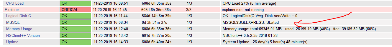

I do not have access to services with the same name but I do have a MSSQL service with a dollar sign in the name.
Here is now the check_nt command is defined
        command_name    check_nt
        command_line    $USER1$/check_nt -H $HOSTADDRESS$ -p 12489 -v $ARG1$ $ARG2$
Here is how the service is setup.
check_command           check_nt!SERVICESTATE!-d SHOWALL -l "MSSQL$"$"SQLEXPRESS"
And it works just fine.
