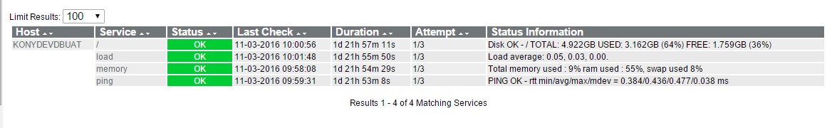

I am basically looking for the disk usage for all the partition to reflect in the Nagios Web interface as i see it currently for 'root' ( refer to attached image )
/ OK 11-03-2016 09:55:56 1d 21h 54m 11s 1/3 Disk OK - / TOTAL: 4.922GB USED: 3.162GB (64%) FREE: 1.759GB (36%)
It depecits all the details, TOTAL, USED, FREE.
