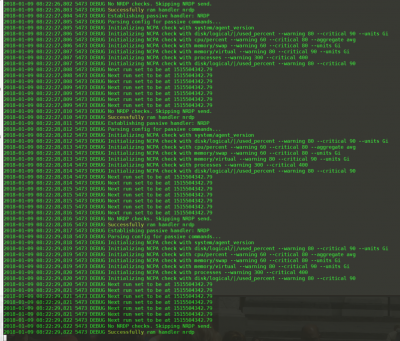

I took a look at the ncpa_passive.log file and for some reason, it looks like the NCPA agent is running the checks every second and not every 300 seconds like it should.

I took a look at the code and I think when debugging is turned on, it is logging every second.
Did, after cleaning up the duplicate checks, did the checks get sent to the Nagios server at the 5 minute interval?
