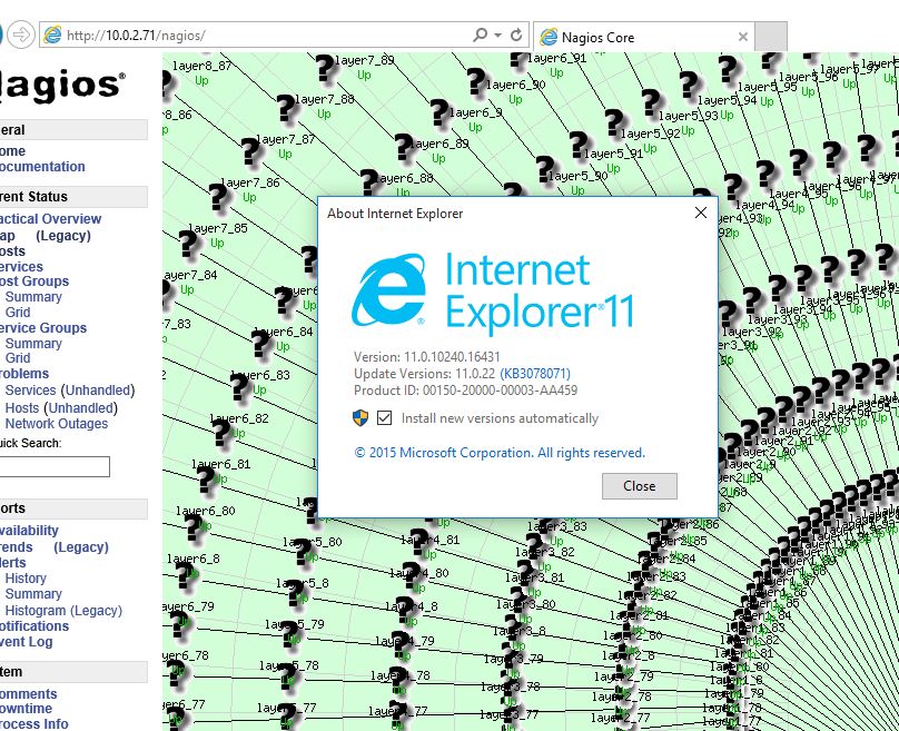

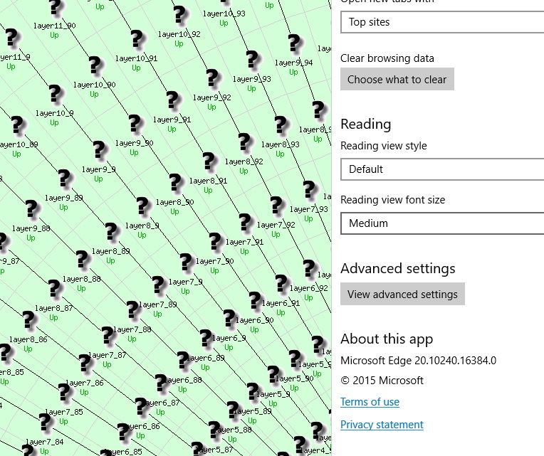

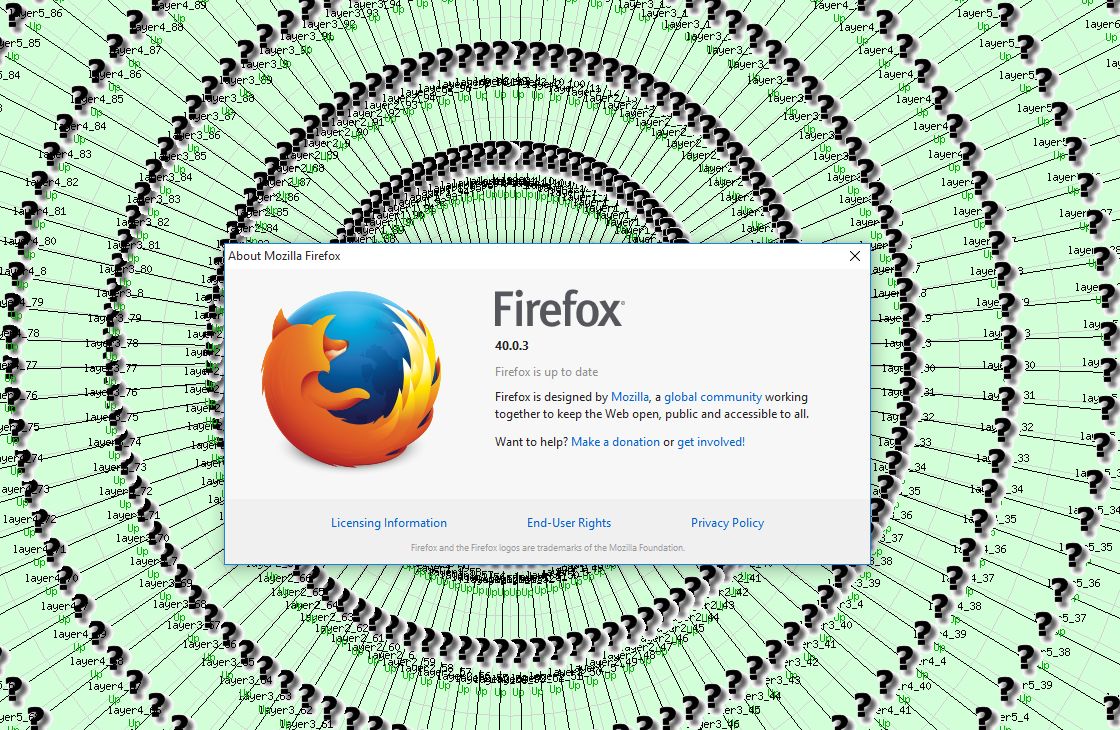

jdalrymple
Skynet Drone
Posts: 2620
Re: Nagios 4.1.1 Statusmap problem
Post by jdalrymple »
I'm not sure how much help it will really be to put my box on the web, I can tell you it isn't easy for me. I'm a lowly support dude, not a network maintainer here at Nagios Inc.
I can offer the following screenshots though for your viewing pleasure.
Sorry, to the best of my knowledge SeaMonkey isn't available for Windows - but last I head it wasn't in heavy use anymore - doesn't even make the list
