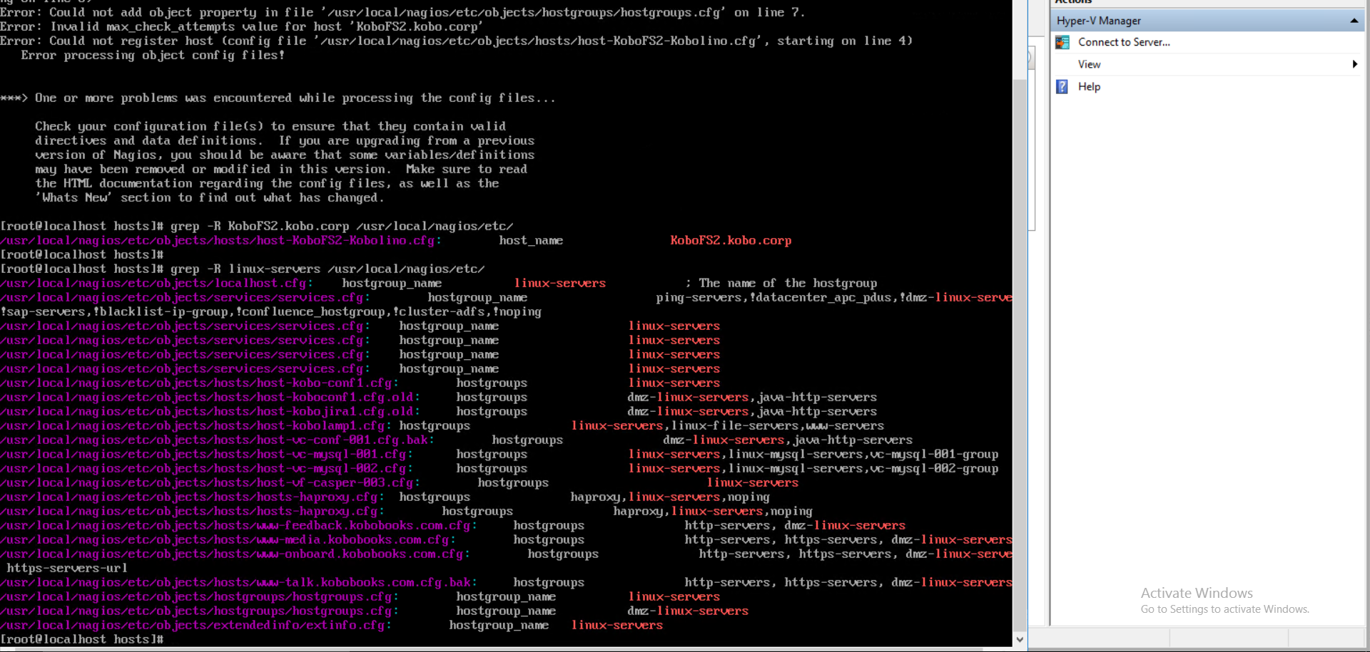

This looks correct.
One thing I cannot be certain of is if there are multiple KoboFS2.kobo.corp definitions, also
grep -R KoboFS2.kobo.corp /usr/local/nagios/etc/
grep -R linux-servers /usr/local/nagios/etc/
also

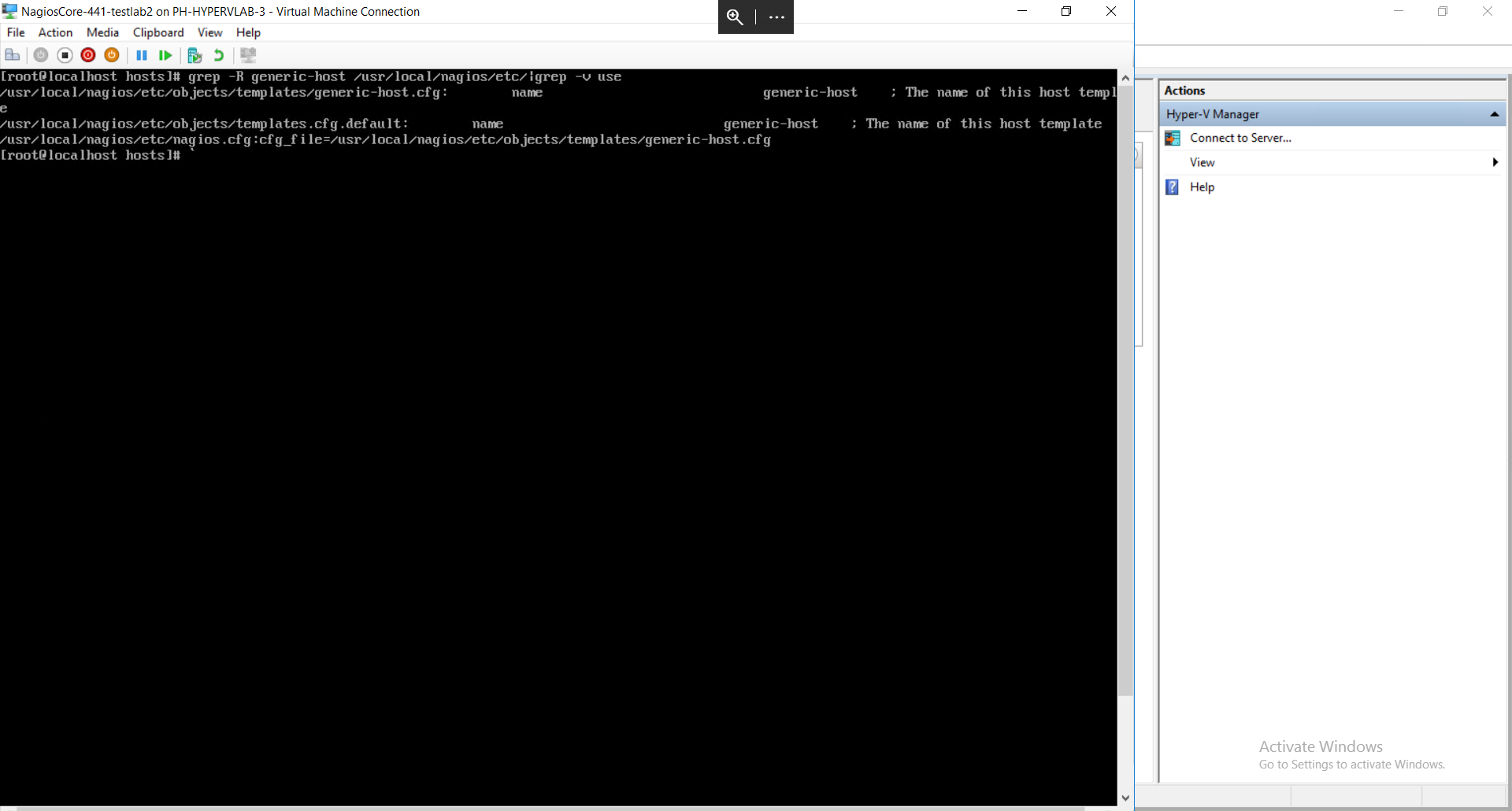

grep -R generic-host /usr/local/nagios/etc/|grep -v use

Ok then i'm out of ideas. The obvious issue is that my host definitions are not seeing both the generic-host and generic-service templates which contain the max_check_attempts value. I have no idea why! Confirmed Nagios is looking at this directory: /usr/local/nagios/etc/objects/templates
I have attached screenshots of the output from the commands you suggested. Looks like generic-host template is only associated with 2 directories, the original templates.cfg I renamed to templates.cfg.default so Nagios would not look at it and only look at the above (my directory).

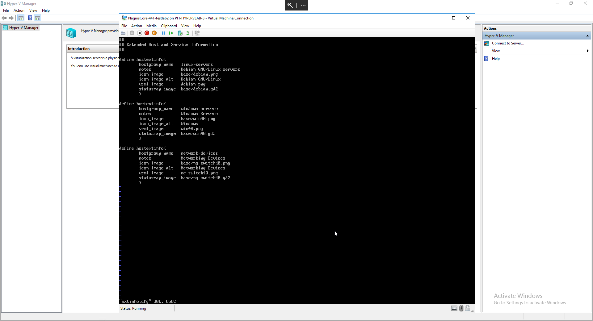

There are couple things left such as, LDAP authentication setup, email (postfix). It did give me an errors for the following configuration file advising "Extinfo definitions will no longer be defined this way in future versions". I"m assuming this will continue to function the way I have it configured for now, however are showing up but not rendering in the web console. See 2 attachments.
Any suggestions where to put this configuration instead of a separate file?
The Extinfo files are no longer used in Core 4+
