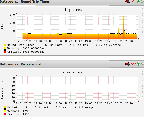

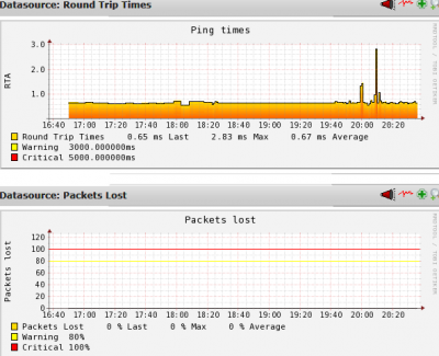

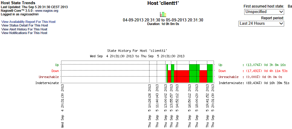

Hi to all, I'm going crazy to configure pnp4nagio (last version) under CentOS.
Even if Nagio working fine and register all Ping Packets Lost, pnp4nagio show in the graphics timeline always Uptime status
This is the Nagio Right status
Right Host Status - Nagios
This is the pnp4nagios Wrong status
Wrong Host Status - Pnp4nagios
As you can see in the second img, there are no critical status nor discontinued interval in the offline host status time

i missing to mention that nagios work fine as you can see in the picture above, host clientt1 status, refer real phisical host status.
The only issues was pnp4nagios that don't show host "down" status in the timeline.

There should be a gap in the host alive graph as it is just an icmp ping check, if the host was unreachable (down), you would see a gap in the graph. pnp4nagios will not show "IP" or "DOWN", but will instead display the performance data for a check, and in this case, it is an icmp ping.
I do want to point out that your server was down until about 16:50, at which time the ping graph has a gap as well. Have you tried altering the timeframe for the pnp4nagios graph to verify if the gaps in perf data correspond to the uptime graph?

In the end I discovered it is because the check_ping plugin does not give useful output if the host is down. It does this:
[sw@nagios01 plugins]$ ./check_ping -H notos $ -w 1000.0,60% -c 4000.0,100% -p 5
CRITICAL - Host Unreachable (notos)
I assume as there are no useful statistics, there is nothing for pnp4nagios to store, so stores nothing. When the host comes back up again, the statistics are again printed (like below), and are stored. When the graph is rendered, it joins up the two most recently stored samples, and because there are no 'down' samples in-between, it looks like it has never gone down! It breaks the Packets Lost graph too.
PING OK - Packet loss = 0%, RTA = 0.35 ms|rta=0.351000ms;1000.000000;4000.000000;0.000000 pl=0%;60;100;0
The check_icmp plugin seems to have no such problem. So to get round the problem, I changed my Nagios config from this:
