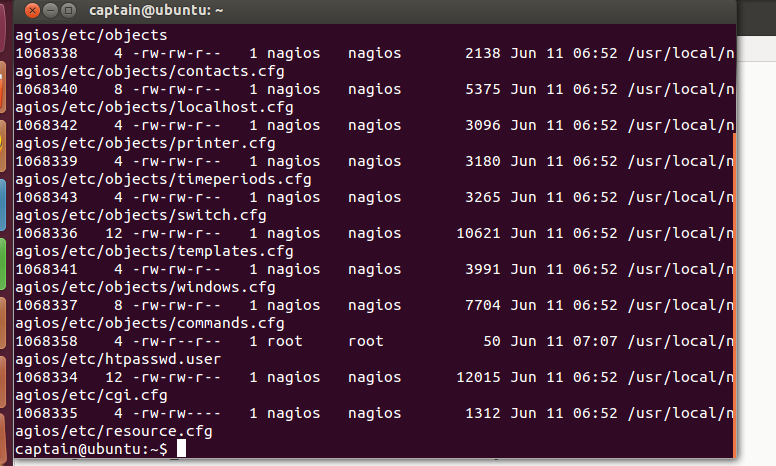

Re: install the Agent on the the system that i want to monit
For fun, please type the following command, exactly as written (copy and paste it), and then paste the results back to your reply in this forum:
find /usr/local/nagios/etc -ls

Hi tmcdonald,
kindly find the attached output.
Thank you. It was me (eloyd) that asked for that, not tmcdonald, by the way.
This tells me that your protections are set properly on the files, so there should be no reason why root cannot edit the files you need to change. Make sure that you are logged in as root and not yourself or the nagios user before editing. You can find out what user you are logged in as by typing "id" (short for identification) without the quotes. You should see something like this:
If you do not see the first part that says uid=0(root) then you are not the root user. You may need to type "sudo -i" first to become root.
