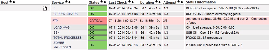

- Posts: 196
- Joined: Mon May 27, 2013 3:16 pm
Re: Graph is not showing in Nagios
Correct but that icon is not appeared next to the Host/Server Name. Only showing Extra Notes option and that also is not displaying properly.
Attached the file with this post.
Still not getting graph of any servers.
Thanks,
Imran Khan.
Thanks,
Imran Khan.
