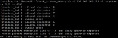

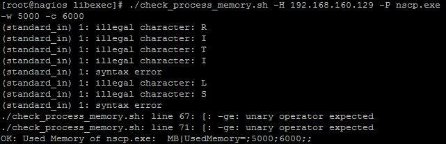

I am configuring check_process_memory.sh in my nagios server.
but i am getting following error and also no out put is returned [screenshot attached] :
[root@nagios libexec]# ./check_process_memory.sh -H 192.168.160.129 -P nscp.exe -w 5000 -c 6000
(standard_in) 1: illegal character: R
(standard_in) 1: illegal character: I
(standard_in) 1: illegal character: T
(standard_in) 1: syntax error
(standard_in) 1: illegal character: L
(standard_in) 1: illegal character: S
./check_process_memory.sh: line 67: [: -ge: unary operator expected
./check_process_memory.sh: line 71: [: -ge: unary operator expected
OK: Used Memory of nscp.exe: MB|UsedMemory=;5000;6000;;
I am attaching the configuration file.
can some one tell me why i am getting this error ??

This plugin is actually running check_nt, which is actually a windows checking utility:
command="\\$perfcount_name($process)\\$perfcount_value"
memory=`$pluginpath/check_nt -H $hostname -p $port -v COUNTER -l "$command" | tr -d '\n'`
mb=`echo "scale=0; $memory/1024000"|bc -l`
Is there a reason why you are not just running the check directly with check_nt?
