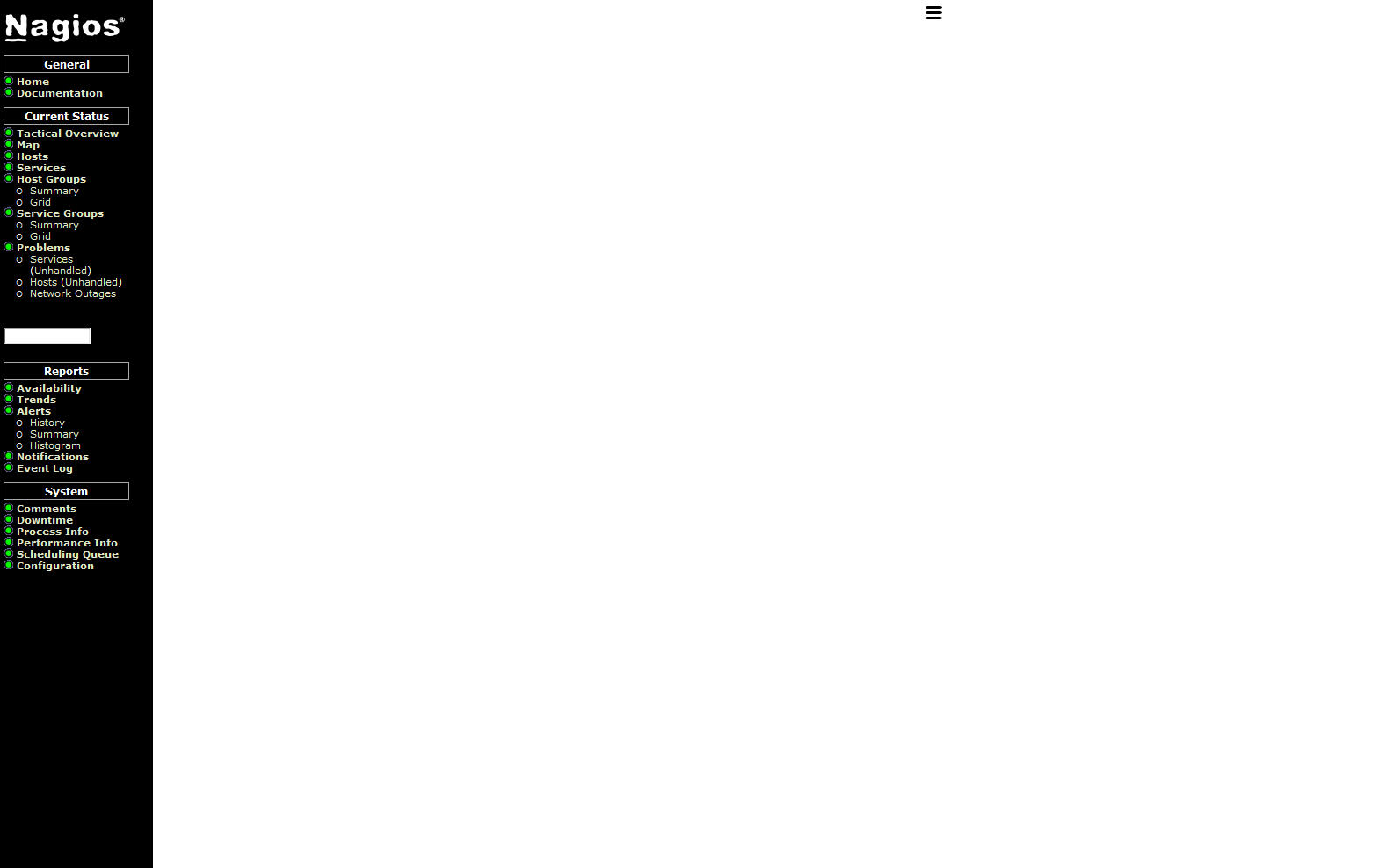

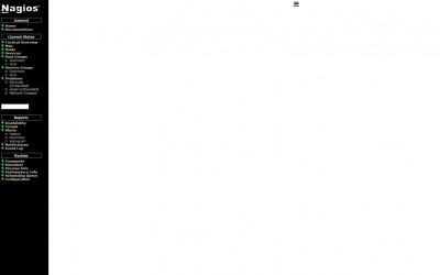

When I click on "Trends" for a host or "Alert histogram" I get a blank screen that has 3 small horizontal lines at very top slightly right of center. I had installed over a working 4.08 system.
Re: Nagios 4.1.0-rc1 "Trends Report"
Is it possible for you to show us a screen shot. Thanks.

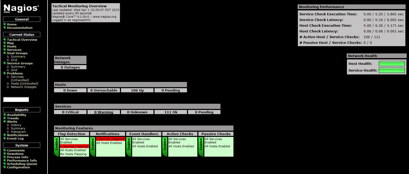

It looks like you're using a custom Nagios Core UI. Can you access the "Trends Report" from Nagios Core itself?
http://nagios.core.ip/nagios/

This is the new core 4.1.0-rc1jolson wrote:In addition to what ssax has mentioned,
