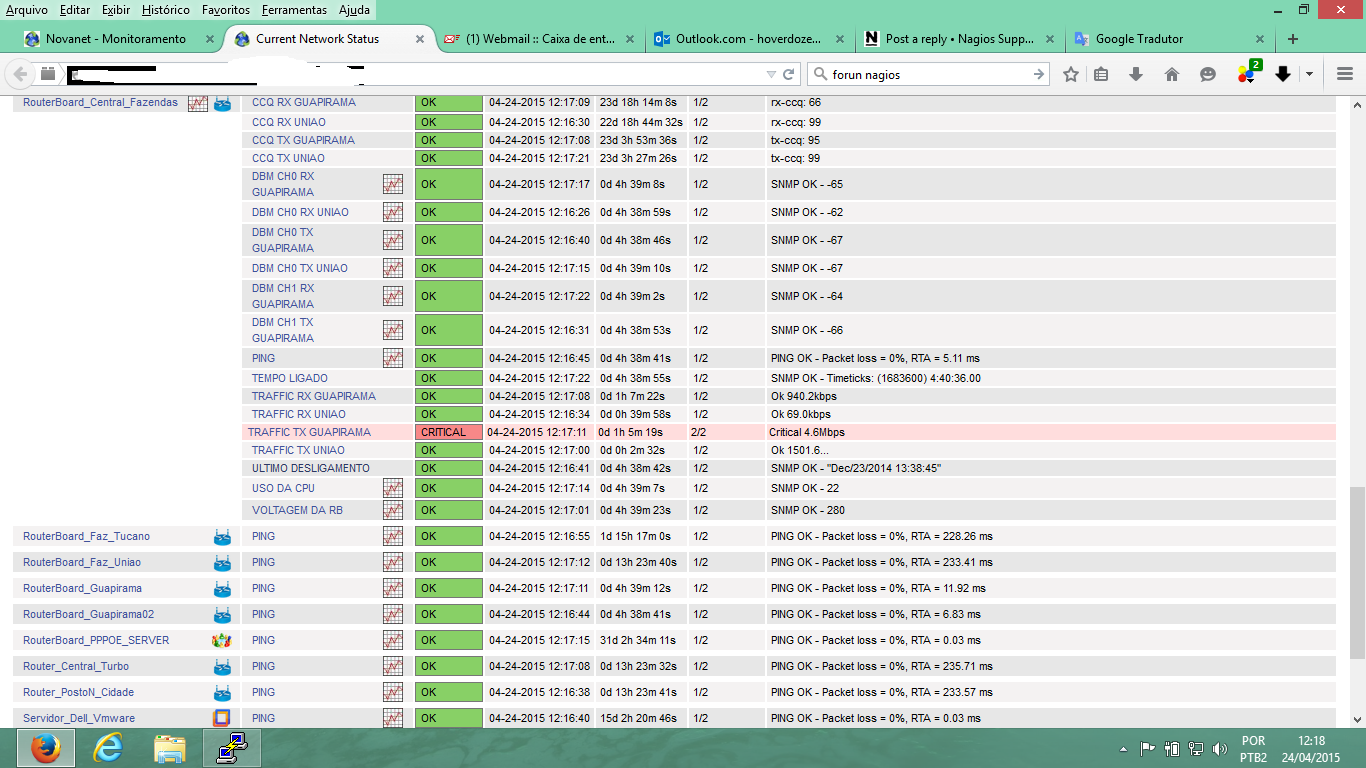

dear friends I modified the script in bash runs without errors in the nagios return critical.
code:
# Bash -x check_traffic guapirama_tx_central farms
SSH output = $ ssh teste@192.168.0.1 "/ monitor-traffic interface interface = interfaceguapirama once" | grep tx-bits-per-second | sed 's /% //'> tx-guapirama.txt
value = 1024
comp = 18432
output = $ (sed 's / tx-bits-per-second: //; s / Mbps //; s / kbps //' tx-guapirama.txt)
output = $ (echo $ output | cut -d -f 1.)
show = $ (sed 's / tx-bits-per-second: // g' tx-guapirama.txt)
if [$ output -g 18]; then echo "$ Ok shows" exit 0;
elif [$ output -l 18]; Then
calc = $ [$ output * $ value]
if [$ calc -l $ comp]; then
else echo "$ Critical shows" exit 2;
fi
else echo "$ Warning shows" exit 1;
fi
exit 3;
good to have this script Graphical this correct? or missing something.

Re: as pnp4nagios do generate the graph of my script?
Please reread my post and the associated guidelines. You need to output a "pipe" character ( "|" ) after your status output, and then a label for the perfrormance data track, and equals sign ( "=" ) and then the value. Try appending your status output with "| rx=$output". for example:
Of this still does not work, try seding out the "Mbps" from the output used for the performance data value.
[snip]
echo "$ Ok shows| rx=$output" exit 0;
else echo "$ Critical shows | rx=$output" exit 2;
fi
else echo "$ Warning shows | rx=$output" exit 1;
fi
exit 3;

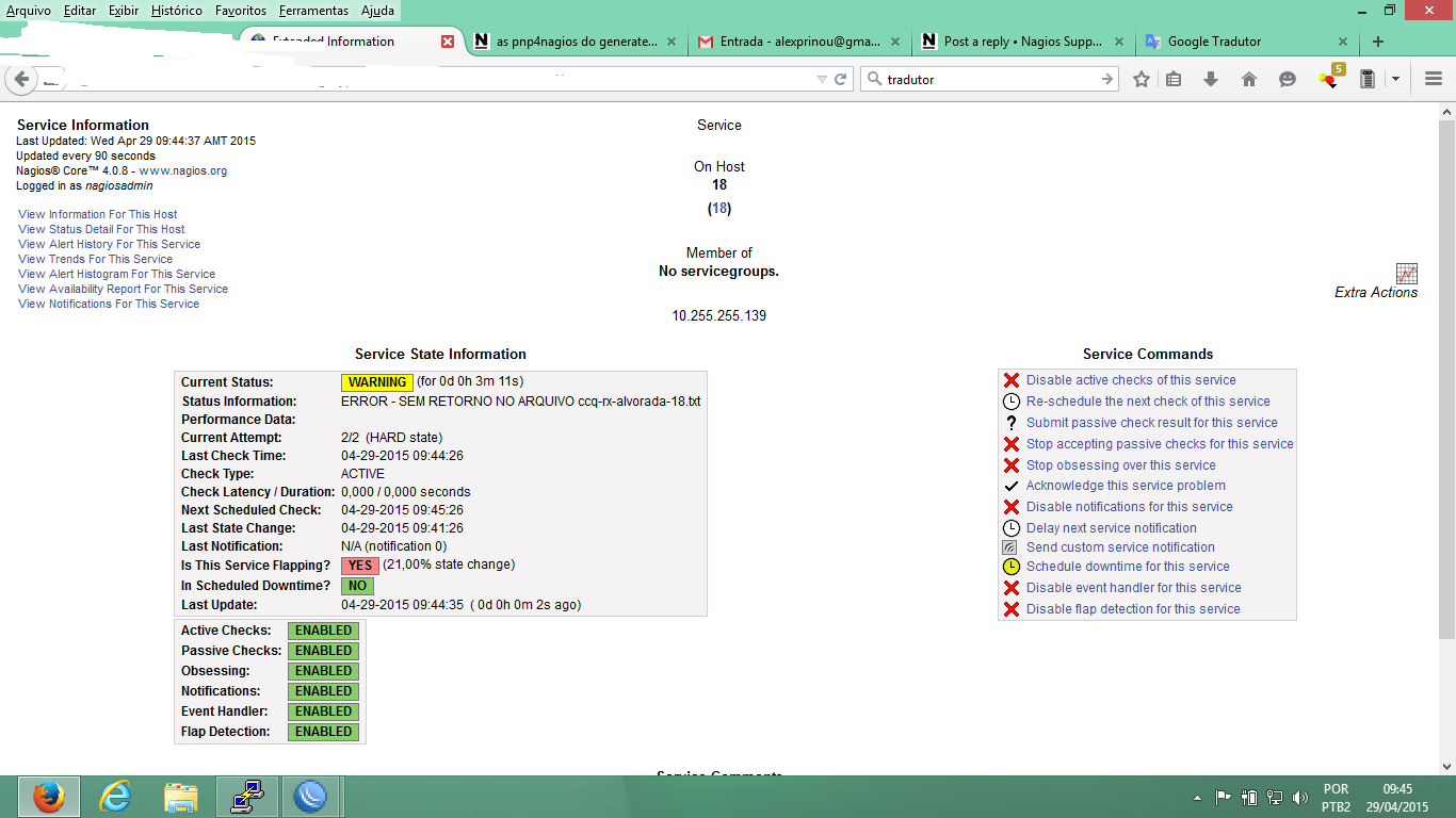

DEAR FRIENDS able GENERATING GRAPHIC NAGIOS NO THANKS TO HELP YOU, MY WHEEL PLUGIN NORMAL IN A NETWORK EQUIPMENT WHEN ADD IN OTHER EQUIPMENT HE RETURNS uknow ERROR.
FOLLOW THE CODE:
# bash -x check_ccq_alvorada_rx_18
outputSSH=$ ssh coleta@10.255.255.139 "/interface wireless monitor 1 once"|grep rx-ccq|sed 's/%//' > ccq-rx-alvorada-18.txt
output=$(sed 's/rx-ccq://g' ccq-rx-alvorada-18.txt)
if [ $output -ge 85 ] ; then
echo "$output % | ccqrx=$output"
exit 0;
elif [ $output -le 85 ]; then
exit 2;
else
echo "ERROR - SEM RETORNO NO ARQUIVO ccq-rx-alvorada-18.txt"
exit 1;
fi
exit 3;
CODE OF RETURN:
nagios:/usr/local/nagios/libexec# ./check_ccq_alvorada_rx_18
: esperado expressão de número inteiro 99
So it looks like your plugin is creating this file:
When you were testing I assume you did your testing as the user root.
When the nagios monitoring engine goes to run the command, it does this as the user nagios.
So what is happening is the user nagios probably doesn't have permissions to the file ccq-rx-alvorada-18.txt.
Delete the file so the nagios user creates it with the correct permissions OR change the permissions on the file so the nagios user can update it.
Does this fix your problem?
