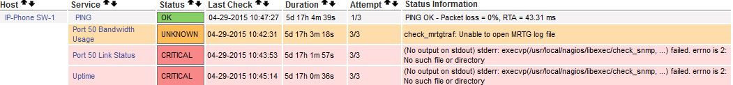

I juts have added one switch with my Nagios. Ping service is ok. But having error on different service. I have installed MRTG. But i think MRTG isn't working properly. Have the bellow snap.

It looks like you don't have the check_snmp plugin installed, see if /usr/local/nagios/libexec/check_snmp exists.
If you don't, you need to install the net-snmp packages and recompile your plugins:
yum install net-snmp net-snmp-utils
cd /tmp
wget http://nagios-plugins.org/download/nagios-plugins-2.0.3.tar.gz
tar zxf nagios-plugins-2.0.3.tar.gz
cd nagios-plugins-2.0.3
./configure --with-nagios-user=nagios --with-nagios-group=nagios
make
make install

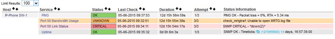

1. Thanks for tutorial. That issue solved & now facing another :( :(
SNMP is UP but its showing critical in status. :( :( :(

Please post your service configuration under Configure > Core Config Manager > Services and find the port 24 service and screenshot it.
For the MRTG issue, you need to place the output files in /etc/mrtg/conf.d, that is where you put multiple files so that MRTG will process them.
Change it from:
cfgmaker --global 'WorkDir:/var/www/html/mrtg' --global 'Options[_]: bits,growright' --output /etc/mrtg/mrtg.cfg [email protected]
To:
cfgmaker --global 'WorkDir:/var/www/html/mrtg' --global 'Options[_]: bits,growright' --output /etc/mrtg/conf.d/172.19.254.61.cfg [email protected]
And then on your next one you add:
cfgmaker --global 'WorkDir:/var/www/html/mrtg' --global 'Options[_]: bits,growright' --output /etc/mrtg/conf.d/172.19.254.62.cfg [email protected]
