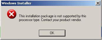

While i am trying to install NSClient++ in Windows Server 2003 R2 it shows that that this package is not compatible with this server.

Are you are trying to install the 64 bit version of the NSClient++ on 32 bit Windows Server?
Try installing the 32 bit version of NSClient++ instead.

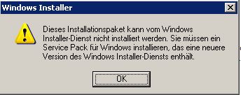

A little update. Just now i have tried with one of my windows server using 32/64 Bit. Its not working. Have a look on the bellow error. Translation is i need to install a specific service pack package for this.
Its little bit depressing. For linux host there is nothing to do. So, for Windows why its becoming necessary to configure in client end? Is it possible to configure in Nagios end without anything configuring in Windows(Client) side? Same what we do for Linux Host!
It will ease a lots of hard work. Expecting your kind help!

lsazzad wrote:Its little bit depressing. For linux host there is nothing to do. So, for Windows why its becoming necessary to configure in client end? Is it possible to configure in Nagios end without anything configuring in Windows(Client) side? Same what we do for Linux Host!
You must have some agent on Linux also - NRPE or SNMPD maybe?
The easiest solution with Windows if you don't want to install packages is to use WMI. Here is a document we publish for our commercial product NagiosXI, but with a little interpretation it should work for Core just the same. It's intended to be used with the plugin check_wmi_plus.pl
http://assets.nagios.com/downloads/nagi ... ios-XI.pdf
