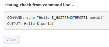

For reference, I made a command that just does echo "Hello $_HOSTREMOTEPORT$ world!" and then gave a random host the _remoteport variable with the value 1234 and ran the test command. These are my results:
2015-07-20 16_14_27-Nagios XI - Nagios Core Config Manager.png (3.79 KiB) Viewed 5393 times
Does this match up with what you are seeing? The condensing of the $_HOSTREMOTEPORT$ macro into a single $ is due to PHP failing to find a variable named $_HOSTREMOTEPORT and then reporting the remaining dollar sign as a literal.
If so, then unfortunately yes - the proper way to test is to save and let it run. There are a few known flaws with the Test Command button, and this is one of them.
