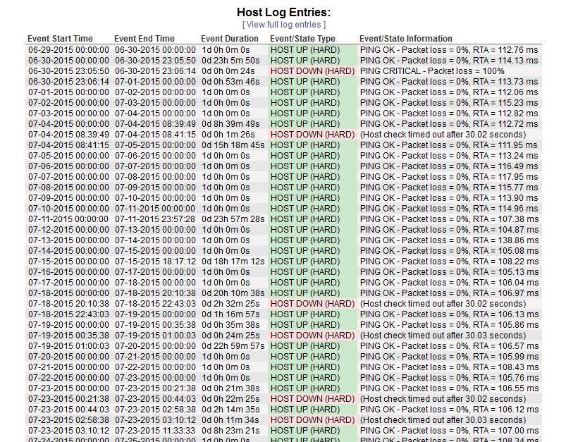

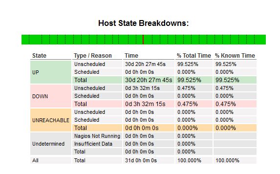

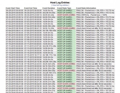

Nagios has the concept of availability reports based upon up/down status. They look like the attachments.
The bigger issue I see here though is that you're wanting to monitor more often than every minute. This is possible with Nagios - but ill-advised. My personal preference to resolve the 1 minute period dilemma is to have a background process submitting passive check results to Nagios.
