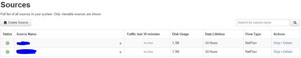

Finally I have decided to test that tool. I have downloaded the VMware Image trial version. However I am trying to monitor two machines (Linux and Window) but in "Sources" I see always the same.
I followed these instructions: https://assets.nagios.com/downloads/nag ... alyzer.pdf
For Windows: https://assets.nagios.com/downloads/nag ... alyzer.pdf
I use Flow Exporter and the port 2001.
What happen? Thanks.
fprobe <NetworkAnalyzer server>:2000

If you click on the source names do you get any additional information?
There are a number of things that can cause this. The NNA box is supposed to automatically handle firewall ports for you, but it wouldn't be bad to verify that they are opened with a `service iptables status | grep 200[01]`
It could be a clock sync issue - this is very common
Double check and make sure your services are running on the collecting hosts.

No, just "No data available" and "No data found".jdalrymple wrote:If you click on the source names do you get any additional information?
[root@localhost ~]# service iptables status | grep 200[01]
2 ACCEPT udp -- 0.0.0.0/0 0.0.0.0/0 udp dpt:2001
3 ACCEPT udp -- 0.0.0.0/0 0.0.0.0/0 udp dpt:2001
4 ACCEPT udp -- 0.0.0.0/0 0.0.0.0/0 udp dpt:2000
How can I check that? Also, for example I don't see anything service in Window for Flow Exporter...jdalrymple wrote:It could be a clock sync issue - this is very common
That is my goal, but I would like try with these machines as well.jdalrymple wrote:For what it's worth, going back to your original problem, the best place to get your flow data would be your mentioned firewall:
Thanks.

Now I am trying to monitor a Windows 8.1 and Centos 7.1. In the Linux case I just follow the PDF and ran this:eloyd wrote:What are the device(s) you're monitoring and how are you sending that data to Network Analyzer?
cd /tmp
wget http://assets.nagios.com/downloads/nagios-network-analyzer/scripts/fprobeinstall.sh
chmod +x fprobeinstall.sh
./fprobeinstall.sh
fprobe [IP NNA]:2055
1. Download the installer from
http://www.flowtraq.com/corporate/product/flow-exporter.
2. Run the installer, accept the EULA and default locations.
3. Choose the interface.
4. Configuring the export:
• Destination Address: Enter the IP of the Nagios NA server here.
• Destination Port: 2001
