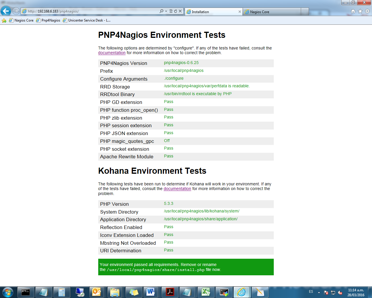

And attached the screen that appears when I try to view graphic.
Posts: 5126
Re: Problem PNP4
Post by Box293 »
Have you tried removing or renaming the install.php file as explained at the bottom of your screenshot?

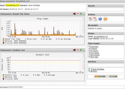

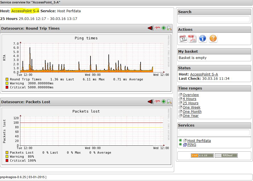

That was just the problem , I thought I had removed in a previous configuration. I can already see the graphic on the button on the right but me this message appears and when I give the address http : //ipadress.pnp4nagios directional me alone to host AccessPoint SA
thanks for your help.
Only sends me to host AcccessPoint SA
This is the first host on the list "AccessPoin S.A"

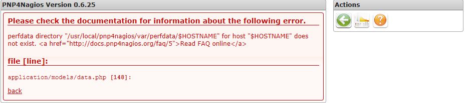

Re: Problem PNP4
When you are seeing that error, can you show us the link you're trying to access?
