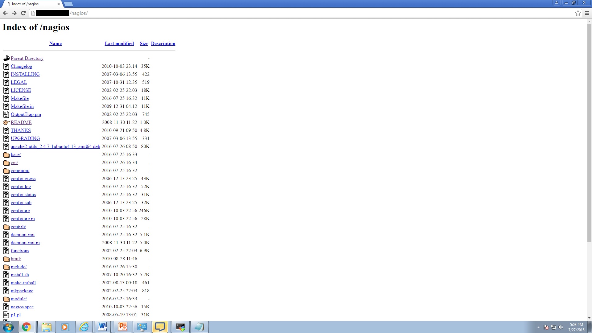

I tried what you said and it still doesn't seem to work.
I included the error log and what was contained in httpd.conf which is the only thing in /etc/httpd/conf.d/nagios.conf/
Also I had htmlCGI as a file path only to test if putting them in the same file would work but I deleted that.
Also included is what I see when trying to run the nagios web interface.
httpd.conf.txt- (1.34 KiB) Downloaded 286 times
errorLog.txt- (98.97 KiB) Downloaded 286 times
