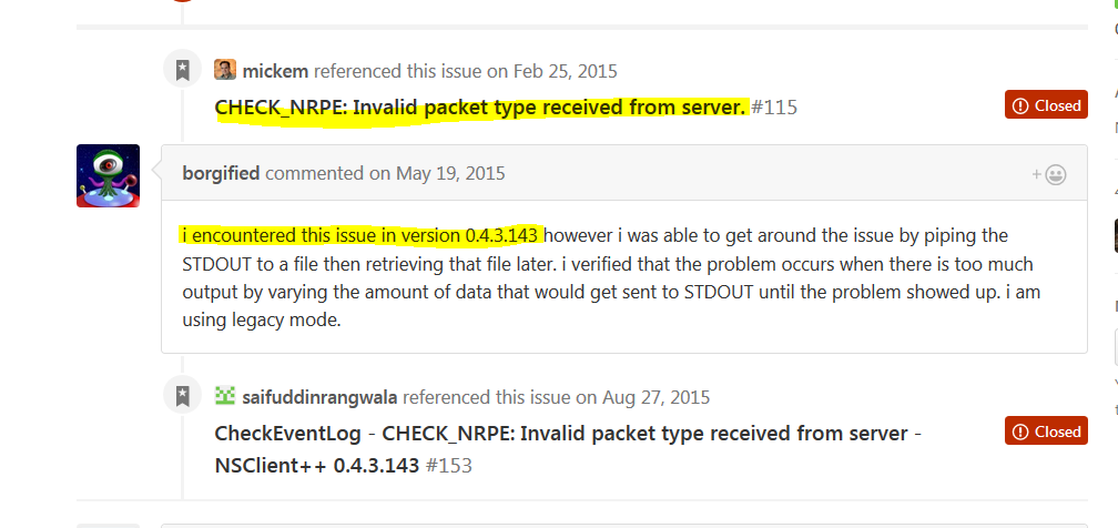

NSClient++ is not one of our products. I would recommend contacting the developer, and/or posting your questions on the NSClient++ support forum. They may be able to resolve your issue faster. I found the same (or similar) issue reported on their forum:
https://github.com/mickem/nscp/issues/83

that is for 4.3 I am using 4.1
do not think it applies
My impression was that you were having this issue with NSClient++ 4.3.143, and NSClient++ 4.1.73 was working fine... You said:
This one give me ---- CHECK_NRPE: Invalid packet type received from server.
The nsclient is 4.3.143 it is a Windows 2003 32 Bit Server
I have Windows 2012 Servers and other Windows 2008 servers all working and all on NSclient 4.1.73
