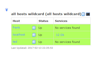

by rkennedy
Did you apply configuration after doing so? Your syntax looks correct, and just tested it over here -
define hostgroup {
        hostgroup_name                          all hosts wildcard
        alias                                   all hosts wildcard
        members                                 *
My guess is you could have other hostgroups or templates interfering.
