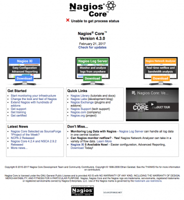

I am having the same issue, as described here. I have just updated following the instructions for upgrading Nagios Core 4 here https://assets.nagios.com/downloads/nag ... ading.html
Main home page shows:
Unable to get process status

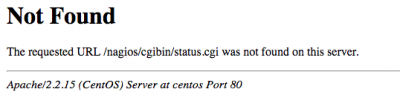

URL to any of the Current Status pages shows:
/nagios/cgibin/status.cgi was not found
Location of status.cgi shows:
location of status.cgi
Screen Shot 2017-02-22 at 10.38.46.png (10.69 KiB) Viewed 10243 times

It looks like we forgot to update that https://assets.nagios.com/downloads/nag ... ading.html page. See the UPGRADING file in the tar ball. I'll see about getting the web page updated.

Yes, it's related to #2. If you really don't want login/logout just add a ScriptAlias /nagios/cgibin "/usr/local/nagios/sbin" to the nagios.conf file.
