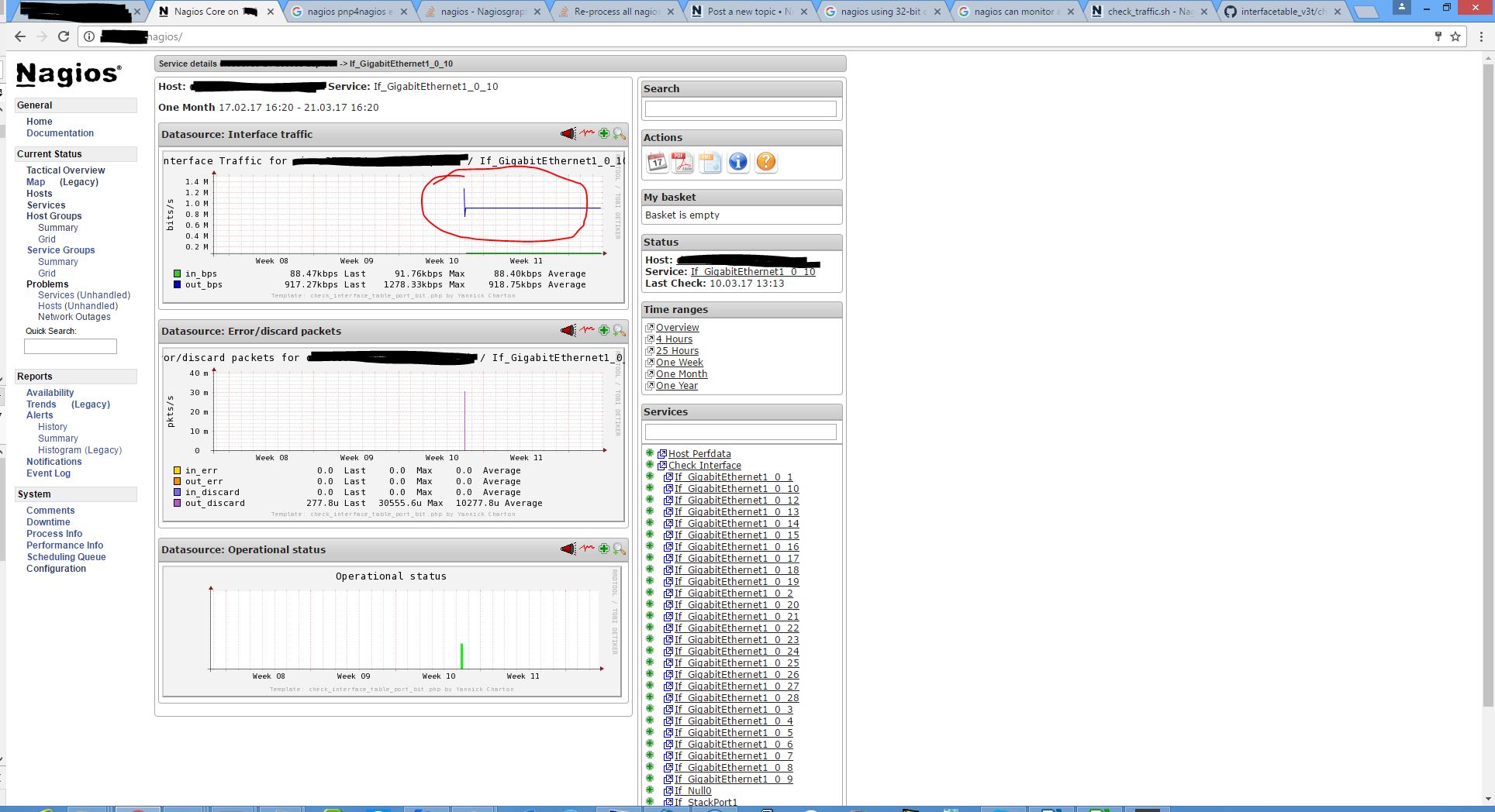

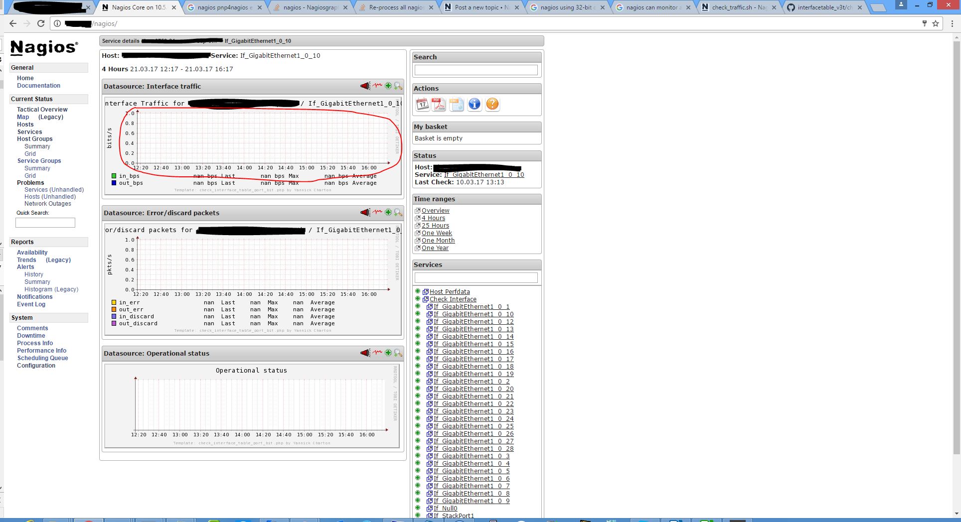

1. pnp4nagios graphs are empty - graphs for example for time period '4 hours' contain no data, please see attach 'epmty_graphs_pic1.jpg'; 'one month' contain some traffic, see atach emty_graphs_pic2.jpg, that was before upgrade,

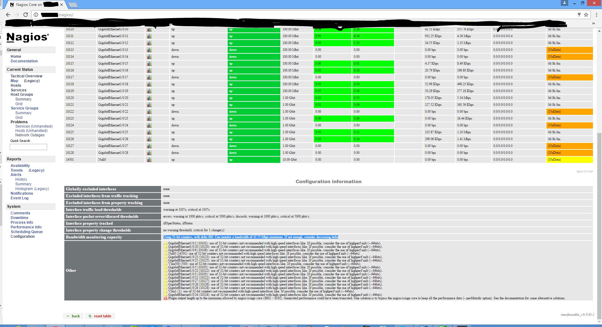

2. nagios doesn't read interfaces' descriptions - instead displaying e.g. 'customername-customerlocation' it displays 'GigabitEthernet1/0/10', see atach 'interfaces_desc.jpg'

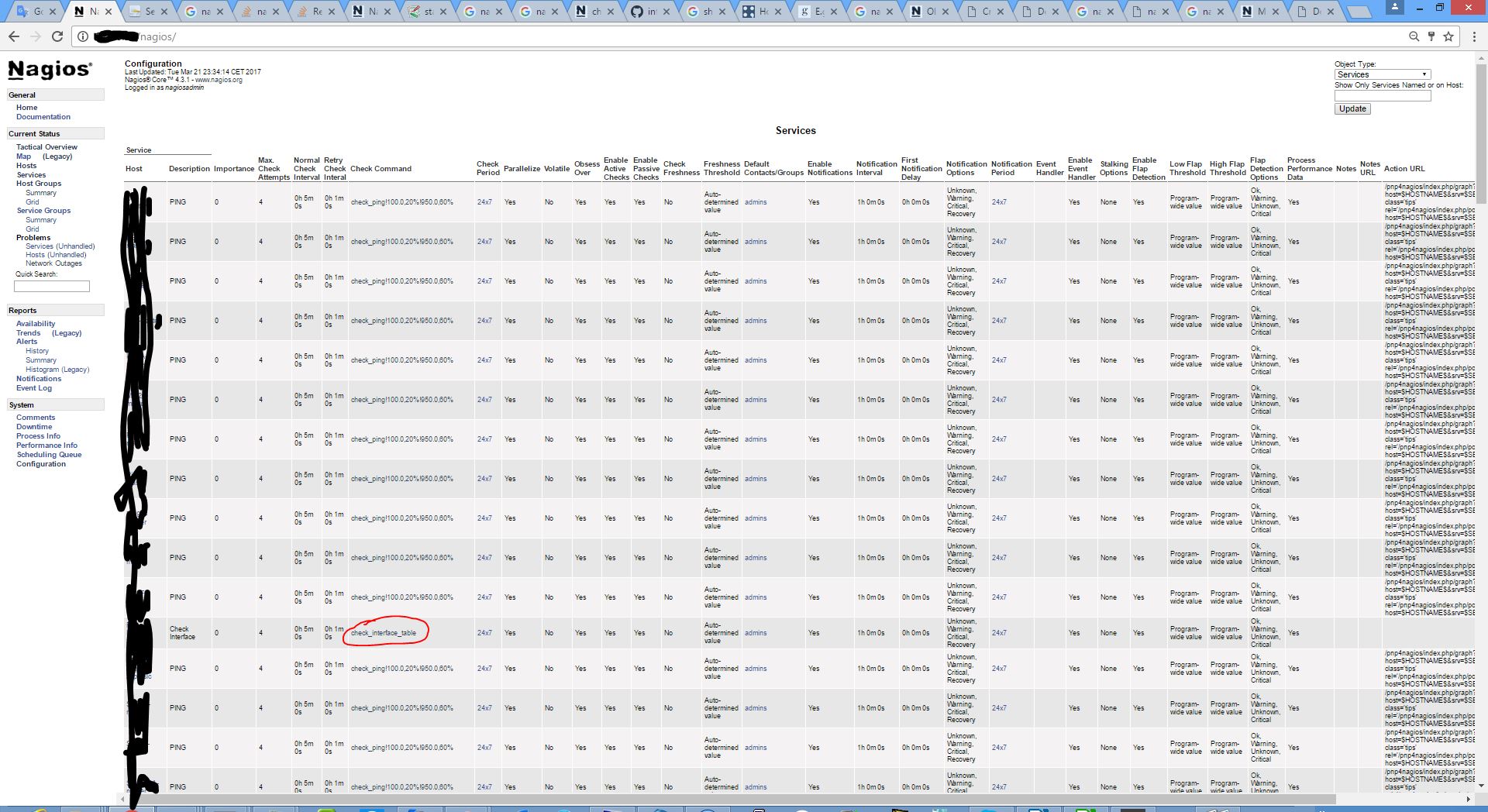

Can you show the definition for you service?
What is the full command and output when run the CLI?
https://docs.pnp4nagios.org/
Previous Nagios employee
Re: Nagios upgrade from 3 to 4.3.1 -a lot of issues

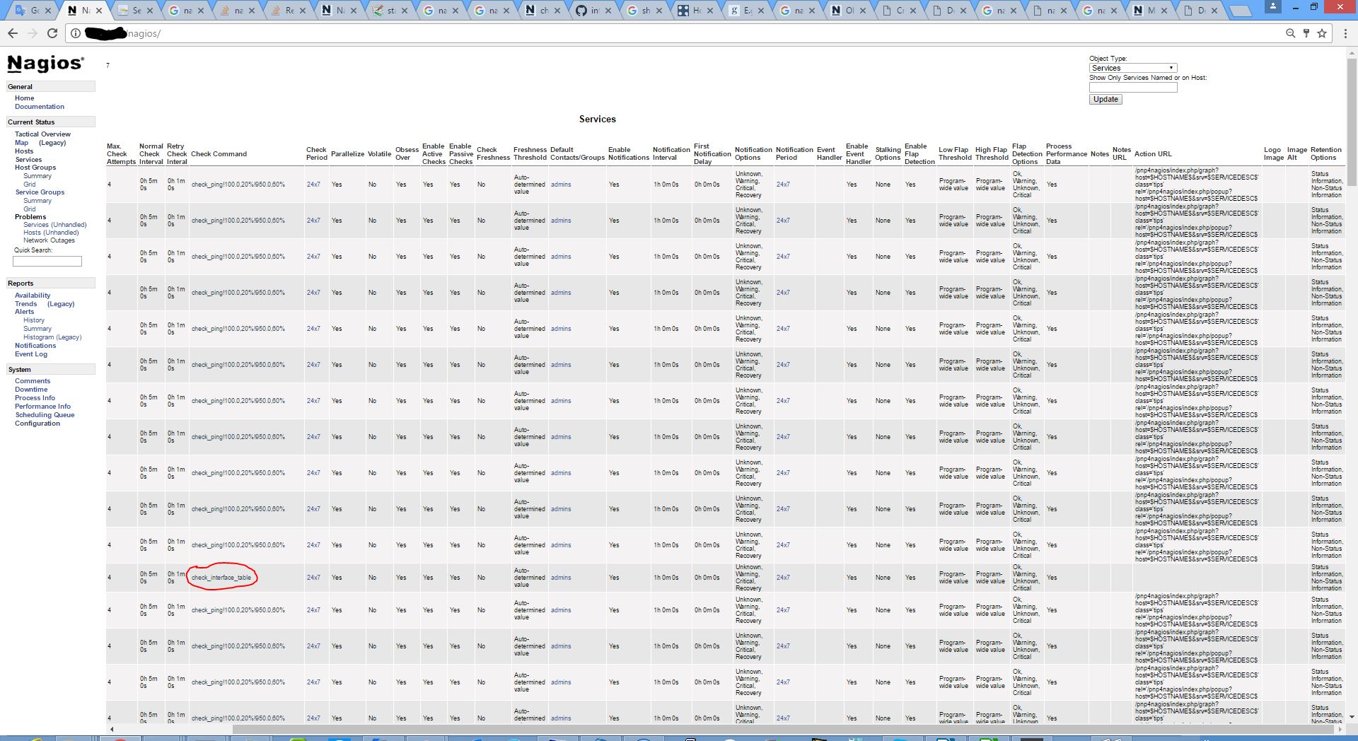

"Can you show the definition for you service?"
Under Configuration - Services I got those rows - see attachments 'configuration_services_1 and configuration_services_2'.
In nagios.cfg a have this line cfg_dir=/usr/local/nagios/etc/objects/some_dir_name/
Inside some_dir_name/ there are .cfg files, and one of them is services cfg file, but the name is not like services.cfg than services-translated-to-my-native-language.cfg (however, I think this is not the cause of issues).
Inside services-but-in-my-native-language.cfg there are only a few lines.
Another cfg file network-equipment-but-translated-to-my-native-language.cfg file contains lines about network devices like this (I'm showing only a few of them below):

And I forgot to add one more, I think useful info, ls -l command inside '/usr/local/pnp4nagios/var/perfdata' directory output this (I'm showing only one directory, there are 80 directories in total):
drwxrwxr-x 2 nagios nagios 4096 Mar 10 13:15 hostname1 -this means there are no writings (updates) to .rrd and .xml files inside those directories, so lately there are no graphs.
So how to find the reason for my rrd and xml files are not being updated?
