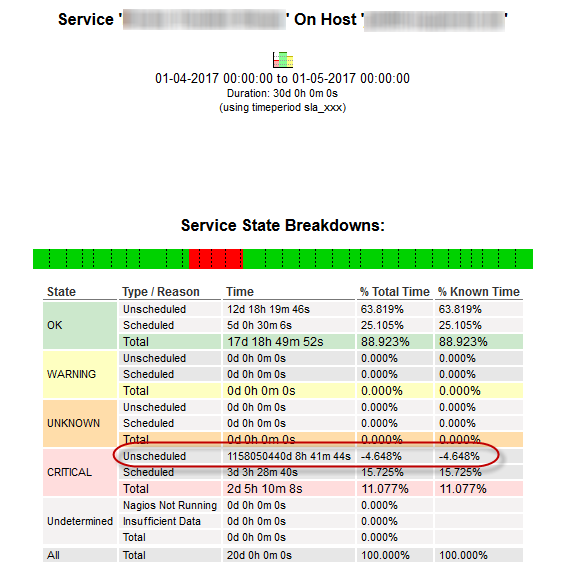

Hi @ll,

The issue is: Some of my availability reports are showing negative %-values as well as incredibly high "Time"-values (e.g. "1158050440d 8h 41m 44s"), see the attached screenshot: I narrowed the issue down to only occur when a scheduled downtime took place during the "Report Period", here "Last month".
The error occurs on any given "Report time Period", except the pre-defined "24x7" and "none". Note: The pre-defined Report time Period "workhours" also leads to incorrect data.
I found some indication on the www that this is up to an error in avail.cgi and that this should have been fixes by now, which I cannot agree to, since I just updated my system on a sandbox to Nagios Core 4.3.2.
The values are somewhat different to my live-environment (being Nagios 3.5.2). However, they're still false (the screenshot is from Nagios 4.3.2).

Report-URL: https://<MY_NAGIOS_SITE>/nagios/cgi-bin/avail.cgi?assumeinitialstates=yes&assumestateretention=yes&assumestatesduringnotrunning=yes&backtrack=4&show_log_entries=yes&timeperiod=lastmonth&rpttimeperiod=sla_xxx&host=<HOSTNAME>&service=<SERVICENAME>

What is the definition of the time period workhours? What is the full output from:

Definition of "workhours" (same as "sla_xxx")
define timeperiod{
timeperiod_name workhours
alias our office hours
monday 08:00-18:00
tuesday 08:00-18:00
wednesday 08:00-18:00
thursday 08:00-18:00
friday 08:00-18:00
}Code: Select all

Would it be possible for you to share the log files which produce this report? If you can attach the minimum amount of time period needed to replicate the issue that would be great. You can compress it and PM them to myself or other support personnel.

Re: Availability report is showing negative values
many thanks again for looking into my issue.
I have stripped down the logs to contain only (IMHO) relevant data. This is the data worth a full month and my tests after cleaning up the logs showed the expected "faulty" result.
I have additionally attached some more screenshots as well as the entire object-definition that's used to reproduce this issue.
If there's anything more that I can do in order to help investigating this issue just let me know.
If you run the Availability report on a host for today, does it still show the error?
This would verify if there is a log file format issue.
Next, run the report again and change the option "First Assumed Service State" to UP and see if the report is correct.
