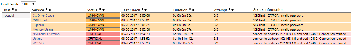

NSClient++
donnyforbes
Posts: 357
Joined: Tue Jun 13, 2017 2:17 pm
Re: NSClient++
Post by donnyforbes »

Here is what I am seeing now. Looks a little different, I want am going to upload a screenshot. I want you to see what I am monitoring etc for now.
Also, How do I change the password? It says invalid. I did put this password in the window.cfg file on the Nagios server. Also, the windows.cfg file is
where I added the hosts , the service to monitor etc... I can see that they all are going to say invalid password. Where do I set this password?
And is it the domain password admin password ?
Please see screen shot.

still getting the following error
C:\ Drive Space
UNKNOWN 06-20-2017 12:30:08 0d 0h 35m 2s 3/3 NSClient - ERROR: Invalid password.
CPU Load
UNKNOWN 06-20-2017 12:28:01 0d 0h 37m 9s 3/3 NSClient - ERROR: Invalid password.
Explorer
UNKNOWN 06-20-2017 12:31:31 0d 0h 33m 39s 3/3 NSClient - ERROR: Invalid password.
Memory Usage
UNKNOWN 06-20-2017 12:32:56 0d 0h 32m 14s 3/3 NSClient - ERROR: Invalid password.
NSClient++ Version
UNKNOWN 06-20-2017 12:34:20 0d 0h 30m 50s 3/3 NSClient - ERROR: Invalid password.
Uptime
UNKNOWN 06-20-2017 12:25:52 0d 0h 29m 18s 3/3 NSClient - ERROR: Invalid password.
W3SVC
UNKNOWN 06-20-2017 12:26:28 0d 0h 28m 42s 3/3 NSClient - ERROR: Invalid password.
I did restart the NSClient on the remote server as well. Is it looking for a certain password?
