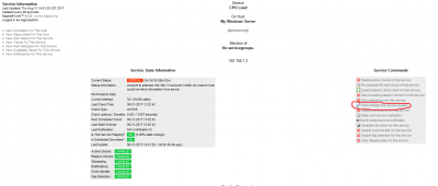

Just to be sure that your going through the right process...I did i a test on notifications and acknowledgements on my core....please follow the below
and don't mind the Nagios Core UI am using,everything is the same..am just using a template from nagios exchange.
This is a critical service and circled in red is the acknowledge link...

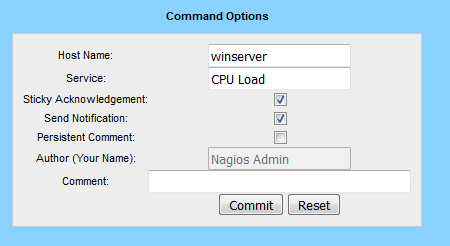

Acknowledge problem from here

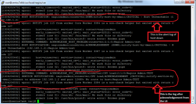

The are the system/nagios logs
After acknowledging you should stop receiving notifications and there should be a log saying acknowledged........ Look at the last image above.
