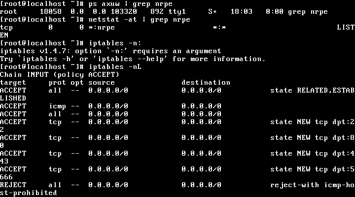

ps axuw | grep nrpe
output:
root 18058 0.0 0.0 103320 892 tty1 S+ 18"03 0:00 grep nrpe
netstat -at | grep nrpe
output:
tcp 0 0 *:nrpe *:* LISTEN

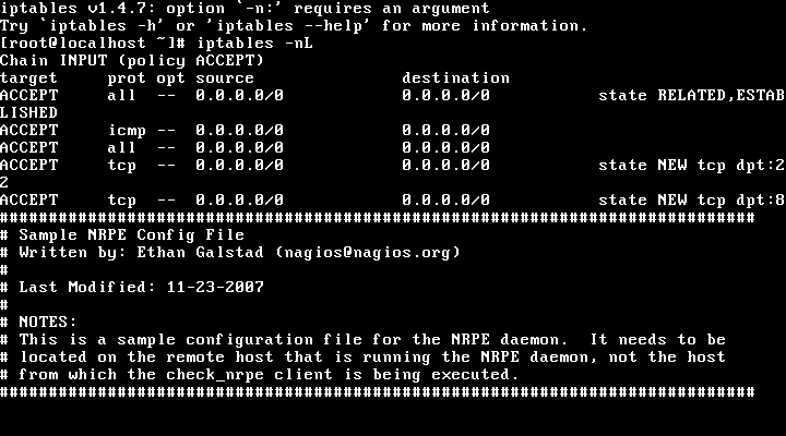

iptables -nL
output:

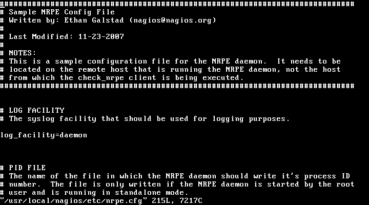

"/usr/local/nagios/etc/nrpe.cfg"
output:
nrpe 1.png (10.22 KiB) Viewed 19675 times

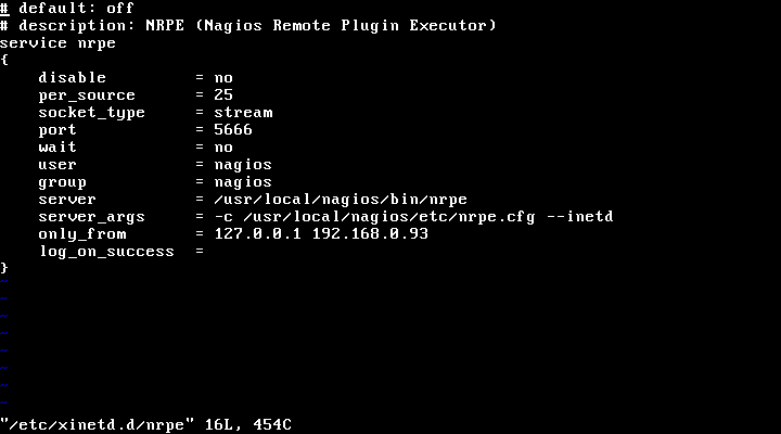

for "/etc/xinetd.d/nrpe"
output:
