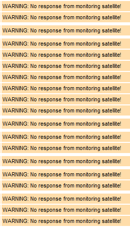

Hello all,
I'm a beginner regarding Nagios and i'm encoutenring an issue on a Nagios installation i'm maintaining.
I hadn't encountered this issue before.
My nagios is as follows.
I have an "Hypervisor" whose is recieveing checks from two remote nagios servers.
These two remotes nagios servers send their checks via NSCA to my Hypervisor.
After updating and checking my config files i have to reload Nagios to update the configuration in the system.
And this is what happens :
NSCA is running, my Nagios process is running, everything should be fine.
And i don't know where to start.

Which version of NSCA is being used? That's not an error message I recognize from either NSCA or Nagios Core.
Are there special scripts/binaries being used to handle the NSCA transmission? Something other than the official send_nsca client?

Regarding the NSCA versions :
Serverside and clientside : 2.7.2
On the server we use xinetd with NSCA.
On our clients we use the standard NSCA client.

What is the error you are getting?

Here's a more forum-friendly version of the image:
Re: Issues regarding Nagios configuration update
If I had to guess the data isn't getting passed to the Nagios server and freshness checking is enabled reporting this.
In order for us to be of assist we would need to see what is kicking off the NSCA command from the remote machine and what the result of running that command is.
