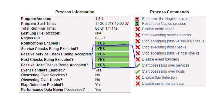

Want check Nagios Core "Process Information" status check using command line.
How to check blow mention Process Information status using command line.
Service Checks Being Executed? [Yes/No]
Passive Service Checks Being Accepted? [Yes/No]
Host Checks Being Executed? [Yes/No]
Passive Host Checks Being Accepted? [Yes/No]
For reference please check attachment.

Those are generally derived from your Nagios configuration:
https://github.com/NagiosEnterprises/na ... #L802-L811
[root@capra_nag ~]# cat /usr/local/nagios/etc/nagios.cfg | grep execute_service_checks
execute_service_checks=1
[root@capra_nag ~]# cat /usr/local/nagios/etc/nagios.cfg | grep accept_passive_service_checks
[root@capra_nag ~]# cat /usr/local/nagios/etc/nagios.cfg | grep execute_host_checks
execute_host_checks=1
[root@capra_nag ~]# cat /usr/local/nagios/etc/nagios.cfg | grep accept_passive_host_checks
accept_passive_host_checks=1
You could also parse status.dat for similar, but slightly different, information:
[root@capra_nag ~]# cat /usr/local/nagios/var/status.dat | grep active_service_checks_enabled
        active_service_checks_enabled=1
[root@capra_nag ~]# cat /usr/local/nagios/var/status.dat | grep passive_service_checks_enabled
        passive_service_checks_enabled=1
[root@capra_nag ~]# cat /usr/local/nagios/var/status.dat | grep active_host_checks_enabled
        active_host_checks_enabled=1
[root@capra_nag ~]# cat /usr/local/nagios/var/status.dat | grep passive_host_checks_enabled
        passive_host_checks_enabled=1

passive_service_checks_enabled etc. status details will update in nagios.log ?
Posts: 3739
Re: How check Process Information using command
Post by mcapra »
If you trigger an external command (or push a button in the GUI) to enable/disable those particular parameters, that should show up in the Nagios log.
Yes, you should see the change in the log if you enable/disable these.
