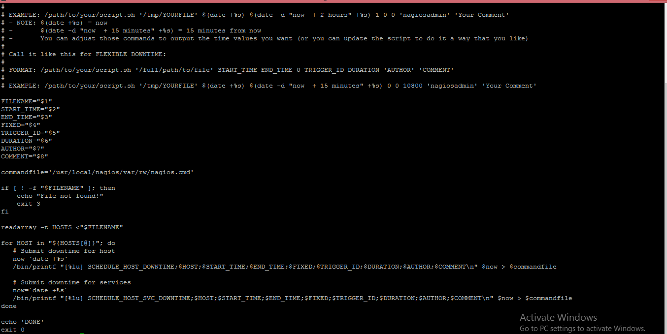

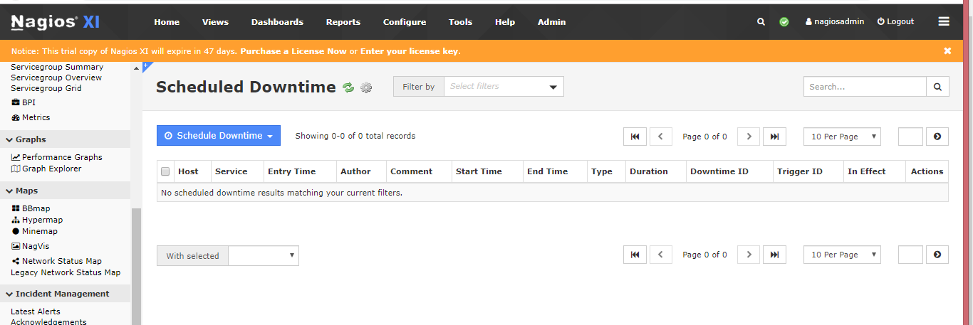

I tried as you said.
1) Copied your script and past in host_and_services.sh
2) added the host in /tmp/hosts which required to put mm
3) Added the start and end time
4) Executed the script, later showing Done but not applied in nagios console
Find the individual attachment so that you will come to know the what we done wrong. Excuted as below
[root@localhost ~]# ./host_and_services.sh '/tmp/hosts' 1556357400 1556368200 0 0 'nagiosadmin' 'patching'
DONE
[root@localhost ~]#
Not applied in console
Host details added in file
Given script by team
