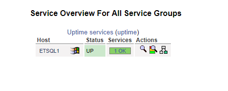

The json query will not show what I'm looking for. I created a service group for uptime succesfully but not displaying what I would like? I would like to see theuptime in day, hours minutes like the status detail page shows below:
Uptime
OK 05-29-2019 10:16:29 0d 23h 44m 6s 1/3 System Uptime - 27 day(s) 3 hour(s) 46 minute(s)
I attached to screen shots one showing what the service group is displaying and the other is the status detail showing the "days, hours, minutes"

Re: Check_nt UPTIME report or group
If you click on "Uptime services (uptime)" right under "Service Overview For All Service Groups" in your second image, you will see what you desire

That's what I was looking for.
