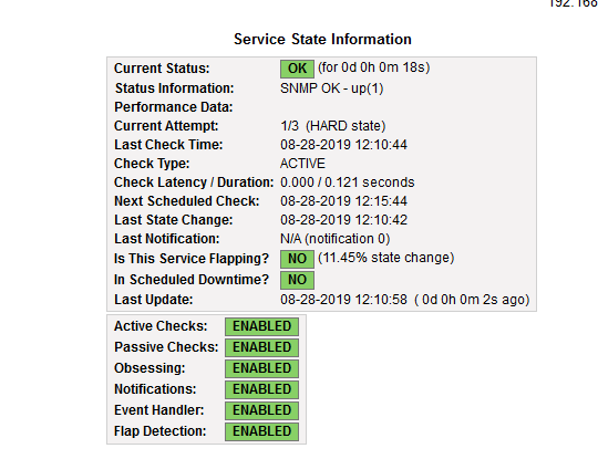

I am receiving the port status is up like below
Current Status:
OK
(for 0d 0h 0m 18s)
Status Information: SNMP OK - up(1)
Performance Data:
Current Attempt: 1/3 (HARD state)
Last Check Time: 08-28-2019 12:10:44
Check Type: ACTIVE

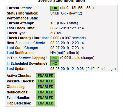

Problem is when the port is down I am getting the Status Information as down but Current status need to change from OK to critical
Current Status:
OK
(for 0d 18h 51m 22s)
Status Information: SNMP OK - down(2)
Performance Data:
Last Check Time: 08-28-2019 12:13:14
Check Type: ACTIVE
Check Latency / Duration: 0.000 / 0.061 seconds
Please help me how can I configure the Current status as critical if the port is down.

Re: Monitor Sangoma Vega Gateway with Nagios Core
Add -r 1 to the commands
example
check_command check_snmp!-C public -o ifOperStatus.6 -r 1
From the docs
In the example above, the "-o ifOperStatus.1" refers to the OID for the operational status of port 1 on the switch. The "-r 1" option tells the check_snmp plugin to return an OK state if "1" is found in the SNMP result (1 indicates an "up" state on the port) and CRITICAL if it isn't found. The "-m RFC1213-MIB" is optional and tells the check_snmp plugin to only load the "RFC1213-MIB" instead of every single MIB that's installed on your system, which can help speed things up.
https://assets.nagios.com/downloads/nag ... uters.html
