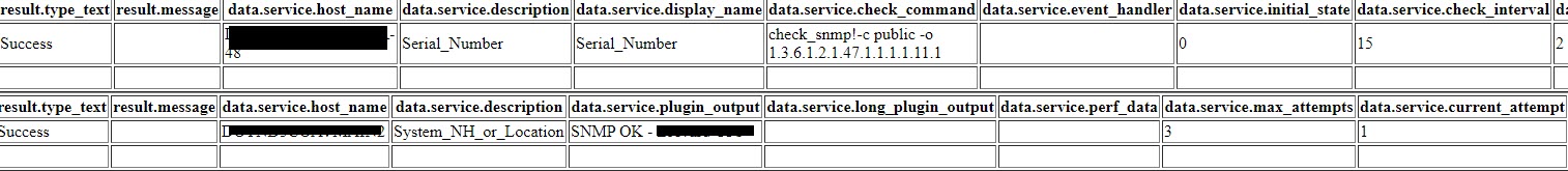

i would love to know how to put the output of the JSON tool into useful information. all i get if i used a json <> html tool is a dorky box look with info all about the fields and service and such but not the actual data in the field. image attached of a serial number check. it gives me a bunch of info but..not the serial number :)

Can you post some examples of the json tool and how you are using it.
