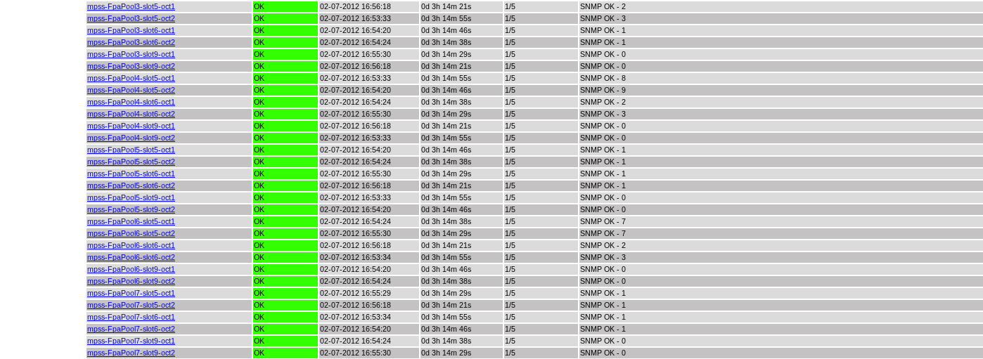

I have these 30 services running on 5 hosts right now and they work fine (see attached screenshot), but if I add the 30 checks to all the hostgroup (40 hosts)
nagios gets crazy.

kasat-mpss-fpa-pool_hostgropup.cfg.txt
screenshot of services running on one host
(18.36 KiB) Downloaded 548 times
