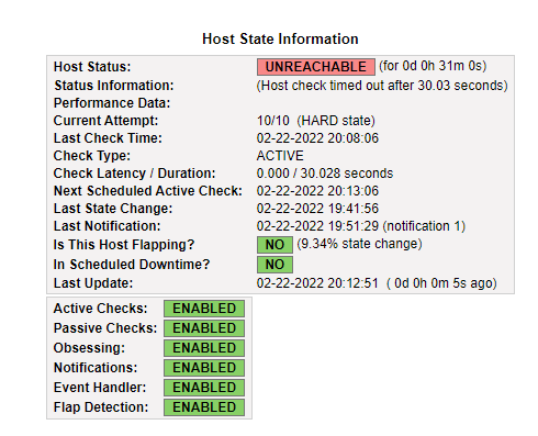

Fresh install of Nagios core on a new server and it can't reach any websites for ping or check_http checks
I'm not sure why because I can ping these websites from within the server itself so the server can reach these sites but nagios core claims every website i have configured is unreachable..
How can I resolve this?
