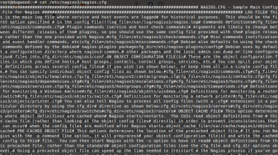

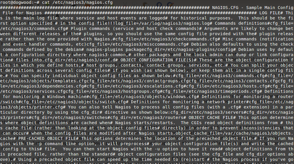

kakarrot
Posts: 12
Joined: Mon Nov 26, 2012 3:21 pm
Re: Failed Migration :: Dif Version Nagios, Dif Version OS
Post by kakarrot »
Here's the main config && thanks for your help agriffin!
root@dogwood:~# cat /etc/nagios3/nagios.cfg

@ agriffin, no bueno. All the spacing was taken out of the entire file & everything is jumbled up now. Take a look at the attachment. Mayb we can slightly alter this command here
# tr -dc [:print:] </etc/nagios3/nagios.cfg.bak >/etc/nagios3/nagios.cfg
Anything else you might suggest? Thanks for your time.
agriffin
Posts: 876
Post by agriffin »
Sorry about that, the command should have been:
# tr -dc [:print:]\\n </etc/nagios3/nagios.cfg.bak >/etc/nagios3/nagios.cfg
(Note the added "\\n".)
