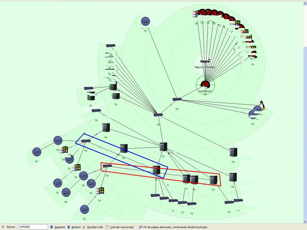

Im running Nagios Core 3.2.3 on a Red Hat Enterprise Linux Server release 5.4 (Tikanga) with aroud 61 Hosts.
I've set up the Nagios StatusMap with "Circular (Marked Up)" Layout Method, and all was fine until i made this change:
In two different hosts, i've set up two differnt parents (for each one).
After that, some lines start to pass over the host icons (see image below).
As you can see on the image; theres no need for Nagios to do that because changing the places of some parents would fix that. How can fix it?
Thanks in advance.
Bye!
PD: Sorry for my poor English.
Nagios StatusMap
Nagios StatusMap
- Nagios Map.JPG (133.12 KiB) Viewed 6469 times

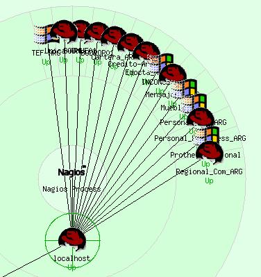

Re: Nagios StatusMap
Hi!
Another Question...
My Nagios StatusMap has about 60 Hosts and some of them are to close to each others, and this cause the Hostname not being visible.
Its posible that Nagios StatusMap to separate the hosts a little more to avoid this issue?
Thanks in advance!
Here's a screen...
Another Question...
Thanks in advance!
Here's a screen...
- Nagios StatusMap.JPG (32.6 KiB) Viewed 6461 times
A couple of things to realize.
1) Systems are drawn around the arcs in alphabetical order. You can arrange children of the same parent by changing their "Nagios name" accordingly.
2) The lines connecting a parent to it's child will never pass through the arc of the grandparent. (The map would become unusable if they did.) The graphing logic will therefore "squeeze" a systems descendants into an arc small enough to insure this doesn't happen.
3) The way to "get around" the issue described in #2 (and spread the systems back out around the circle) is to "split" the parent. (See the attached image.)
Splitting a parent simply means having multiple Nagios definitions for the same physical device (A and B in my case). Consider the following two host definitions (two names for the same system) and see the effect on the map segment. Sure it "looks like" two routers but YOU know better. Then you can evenly split the children between the two (some name A as the parent and some name B as the parent) to help spread them back out.
Finally keep in mind that the circular graph is really only useful in small environments. The techniques described above can extend the usability into somewhat larger arenas, but once you get into hundreds of systems it gets too compressed no matter what you do.
In your first image, look at the lines drawn from the second and third routers out to their children. In the first case the lines will not enter the arc of "localhost" and in the second case they will not enter the arc of the first. The descendants of those systems are squeezed around accordingly, despite their number, and thereby reduces the slice width that ANY single system is allowed to have.
