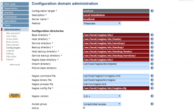

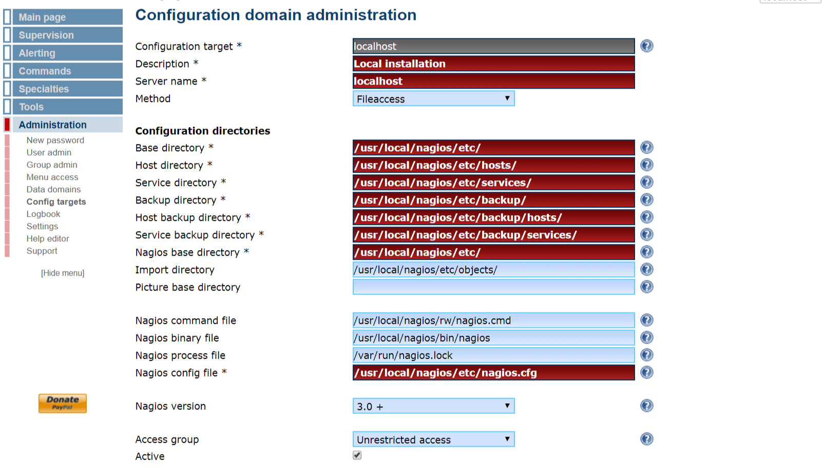

Heya @npolovenko, sorry for slow response, workload sometimes gets me.
Here is the output from first command:
All seems well and ok, doesn't seem to need fixing but I ran it anyhow to reindex it. Output bellow as well:
Same error at the bottom in red persists even after running those 2 commands. As you can see in provided pics:
https://imgur.com/a/l3SQj
If you need nagios.cfg or additional info, let me know.

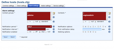

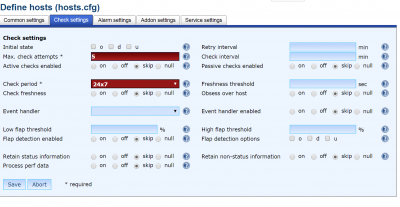

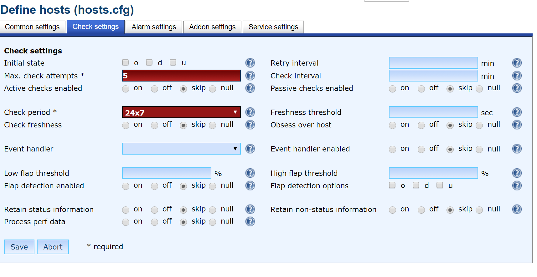

@Shwele, Make sure that when you add a new host you fill out all the necessary fields in check_settings and alarm settings tabs.
After you make these edits resave the configuration. Make sure that your test host gets actually added to /usr/local/nagios/

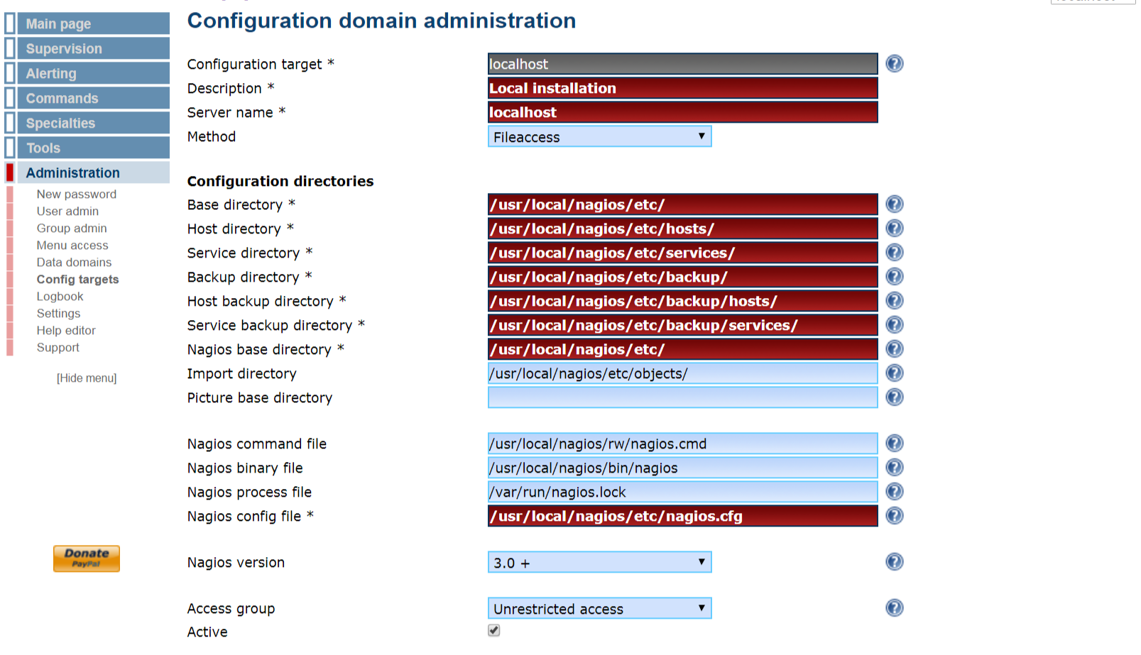

Also, make sure that your localhost config target has the right destinations set up. They have to match paths on your system.You might need to import timeperiods.cfg in Tools/DataImport.
As far as your MYSQL error, we were unable to replicate it. We followed this tutorial: https://tecadmin.net/install-nagiosql-w ... ntos-rhel/ But we used CentOS for our installation.
My personal recommendation would be to manually copy, modify and paste new hosts configurations into the right files in core. You don't really need to use NagiosQL unless your organisation has thousands of machines. At that point you might try Nagios XI which has a Core Configurations Manager which is a big step forward from NagiosQL.
Re: You have an error in your SQL syntax - NagiosQL
@npolovenko Looks like that was what was lacking, check_settings for the host itself, totally forgot about that.

@Shwele, Did you create new services through Nagios QL or did you import them from Nagios Core using the data import tool? I think the problem can be caused by wrong configuration paths. You should go over every line in that menu and make sure that all the paths are set up right for your particular system.
If you take a look at my host and service directory, it says /usr/local/nagios/etc/hosts and /usr/local/nagios/etc/services.
I had to add these to lines in nagios.cfg:
Than i imported localshot services from Nagios Core using the import tool.
Your issue could be caused by a lot of things. You should go to /var/log/ and look through all logs to see if you can find something.
