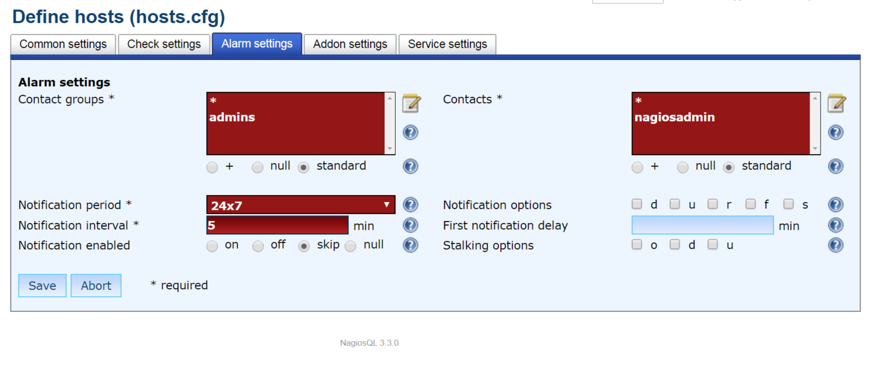

Hello guys, I finally am able to reset config with NagiosQL via interface, but I am unaware whenever this issue is alarming or not.
When I want to add new host/service/group on the bottom of page is written:
You have an error in your SQL syntax; check the manual that corresponds to your MySQL server version for the right syntax to use near '`value' at line 4

@Shwele, Make sure that when you add a new host you fill out all the necessary fields in check_settings and alarm settings tabs.
After you make these edits resave the configuration. Make sure that your test host gets actually added to /usr/local/nagios/
Also, make sure that your localhost config target has the right destinations set up. They have to match paths on your system.
You might need to import timeperiods.cfg in Tools/DataImport.

@npolovenko Looks like that was what was lacking, check_settings for the host itself, totally forgot about that.
