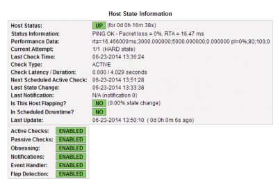

My question is related to the "Next Scheduled Active Check:" when I click on the host.
The next check on the host page seems to be every 20 mins (See image below)

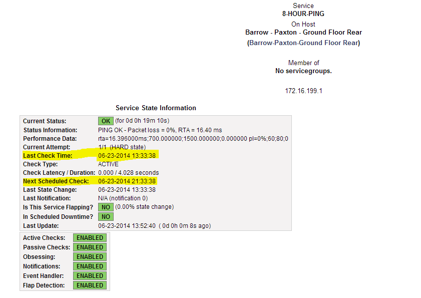

However, if I click on the 8-HOUR-PING service for this host it says the next check will be in 8 hours (see below)
Can anyone tell me if the host will be pinged every 20mins or every 8 hours?

Hosts are checked independently of services. If you want an 8 hour check on the host, you need to change the host check interval, not the service check interval.
By the way, your interval is 15 minutes, not 20.
