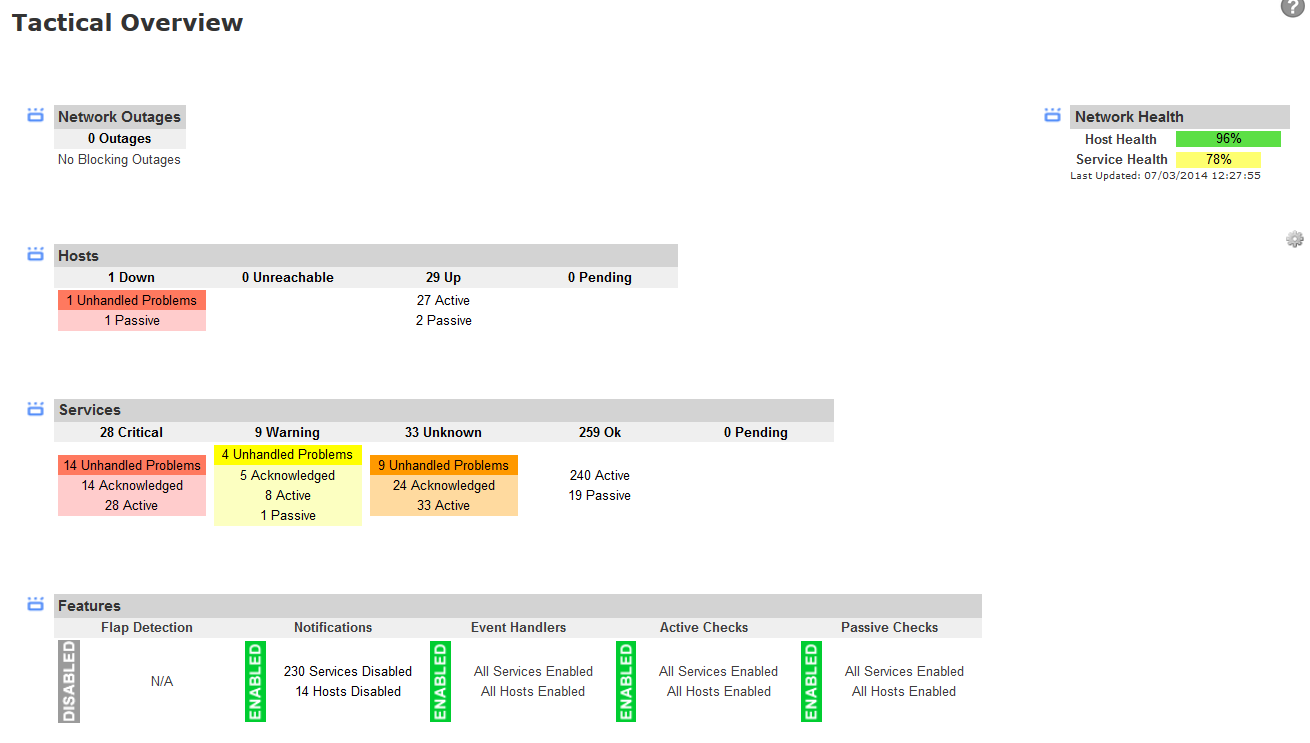

i have passive checks (passive checks enabled, active checks disabled).
in Tactical Overview this checks are shown as disabled
printscreen in Tactical Overview
now i search an option or something like this to show this check not in "X Disabled" but in "X Unhandled Problems".
because some of our admins don't give a f*ck on the "X Disabled", they just have a look on the "X Unhandled Problems".
is there an option like this?

These are different options:
"Unhandled Problems" are services "Not In Scheduled Downtime & Has Not Been Acknowledged & Active Checks Enabled".
"Disabled" are services with "Active Checks Disabled"
I don't believe you can change that. In Nagios XI, you can see how many services in a certain state are "active" or "passive", so I believe this is more intuitive.
