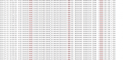

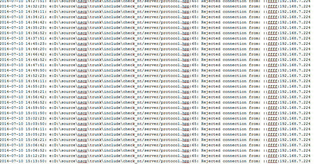

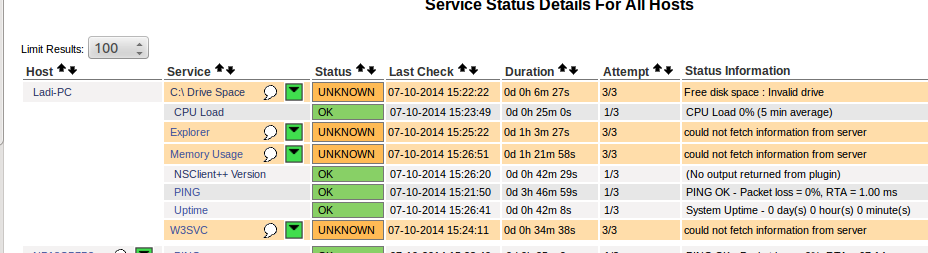

Am trying to setup nagios to monitor a window server which have done but am having some issues, after installing the agent on the window and configure all the necessary part on Nagios server, am having the below error on my Nagios.
could not fetech information from server and (No output returned from plugin), Free disk space : Invalid drive . have checked nsclient++ and i could see some error. Kindly see below attached log, nsclient.ini file and nagios screenshot.

Could you also post the .cfg file from your nagios server which has these services defined in it?
As for the nsclient1.ini file and from looking at the screenshots, you need to:
Replace
allowed hosts = 127.0.0.1
With:
allowed hosts = ::ffff:192.128.7.224
And then restart the NSClient service.

Have tried it and it works fine. I passed in the ip and suggested and i left the password space blank. After all this, i restarted my NSCleint++ and nagios server and everything works perfectly.
