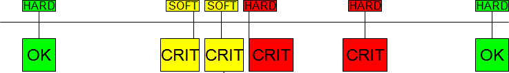

I give a Nagios training presentation that talks about the "Nagios Timeline." Basically, take what Trevor just said and turn it into a lot of text and one picture:
If a service is OK it is in a HARD state.
In normal OK state, checks are performed at check_interval intervals.
If it then becomes non-OK, it is in a SOFT state.
  Further checks are made at a decreased interval (retry_interval)
Services remain in a SOFT state until they have had max_check_attempts successive non-OK attempts.
  At that point, they are in a HARD state equal to the last status (HARD WARNING or HARD CRITICAL).
  Further checks are made at the normal interval from now on (check_interval).
Services that are in a non-OK HARD state that then become OK are placed into a SOFT OK state.
  The next check will result in a HARD OK if it is an OK status, or a SOFT version of a non-OK state, and this process repeats.
This allows for “instantaneous” outages that don’t immediately trigger notifications or event handlers.
The picture shows the normal check_interval until something goes wrong, then a max_check_attempts of 3 being checked at the reduce retry_interval until it goes bad, then it changes back to check_interval until it goes OK.
