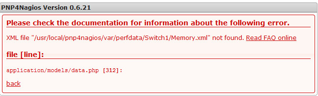

Lastly i am trying to graph the data using pnp4 nagios ,i just add srv-pnp on the service ,just like before but it yielded the error below. Any idea on this?

Re: check-cisco.pl : No such file or directory
Hi All,
Update:
I have now a graph
, i've just deleted the MB in the line below which is the supposed unit
$perf = "memory_total=$mem_total\ MB memory_used=$mem_used\ MB";
and also in the CPU ,i have deleted the percent word
$perf = "cpu_5s=$load_5s\ percent;$warn;$crit cpu_1m=$load_1m\ percent cpu_5m=$load_5m\ percent";
PS: Thank you for all the feedback, if you have other method that is more neat or correct than what i have done ,please do teach me
Update:
I have now a graph
