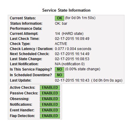

That syntax looks proper to me ocolin, and works in my environment:
        command_name    check_dummy
        command_line    $USER1$/check_dummy $ARG1$ $ARG2$
        use                     linux-server
        host_name               localhost
        alias                   localhost
        address                 127.0.0.1
        _COMMUNITY              bar
        service_description             foobar
        use                             local-service
        host_name                       localhost
        check_command                   check_dummy!0!$_HOSTCOMMUNITY$
Maybe check for awkward whitespaces and such?

Oh wow, I apologize for that. You were the victim of me editing code, then editing posts with edited code. I wanted to make sure that my check would work just the same using the exact syntax you used so I made some adjustments on the fly. I'll fix it to what it looks like in a working configuration. I guess to clarify - I'm now using the same exact syntax you're using and it's working for me.
