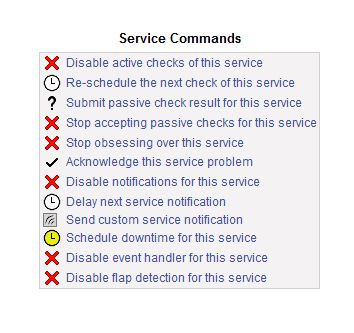

It is not common behavior. There are only 2 (standard) ways to affect the running behavior of Nagios, reload with a modified configuration or send direct commands through the cgis. Are you sure that nobody hit the "Disable active checks" button?

I remember seeing a red x for that option, so I'm going to say no one hit that button.
