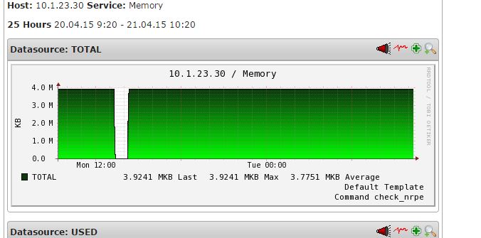

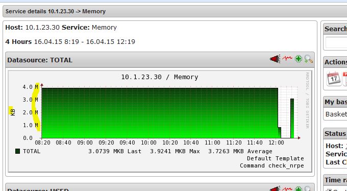

As given script i implemented into nagios. below is the output.
root /usr/local/nagios/libexec # ./check_mem -u -w 80 -c 90
CRITICAL - 94.1% (3.53 GB) used!|TOTAL=3.75GB;;;; USED=3.53GB;3;3;; FREE=0.22GB;;;; CACHES=2.89GB;;;;
but after apply my graph is stop generating here i attached screenshot at apply time please check and one more thing left side it`s showing GB but X row
not reflecting GB it`s showing same as MB into X row
After this again i revert to same previous KB post script and graph again generating So can you check why graph is stop and also check with X row showing MB.
both screenshot here i attached.
jdalrymple
- Skynet Drone
- Posts: 2620
Re: Memory utilization require into GB
The perfdata has no concept of units, it's just numbers (scalar). The Units provided are just a nicety so that we know what we're looking at. Yesterday when you were using 1 GB of memory the graph showed the scalar 1048576 to represent that metric with KB. Today it uses the number 1.jdalrymple wrote:Also be aware if you swap this one in where you used to have KB, Nagios WILL NOT handle the adjusted perfdata properly.
If you wait until the old data rolls off the perfdata charts will be proper again, and the units will adjust themselves appropriately.

HI Team,
Even After as suggest change with new script for check_mem graph has been stop and waiting long data is not populating into GB.
please find below screen shot. kindly provide better script for check_mem can be work.

It looks to me like the units are correct but the labels are wrong (unless the monitored system only has ~4MB of memory in use?) This is because the perfdata was created with a different unit. In order to have proper data the RRD file will either have to be modified or the whole service will have to be wiped out and rebuilt (removing old perfdata and starting fresh).
I recommend the 2nd since your old perfdata is no longer useful in the context of your current service, and it's easier.

HI Team,
Here i given graph after apply new script graph is not generating. you have new script for checking memory usage for GB

Can you try creating an entirely new service and see if you get a memory graph that suits your needs?
The problem is that you're trying to combine perfdata measured with KB into one measured with GB. This cannot work.
