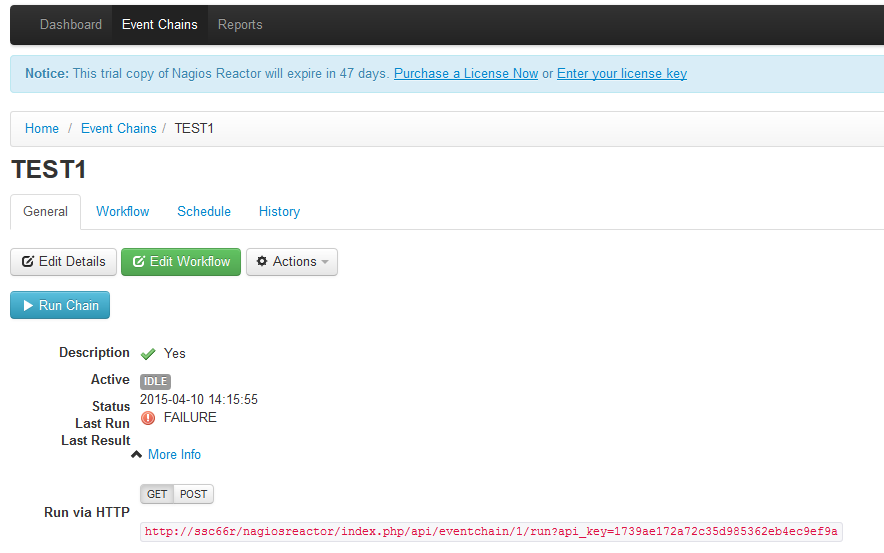

And you can grab the URL of the event chain by going into your even chain and clicking more info (see screenshot).
When anything accesses that URL it will automatically run that event chain, so when curl or wget runs from your event handler it will run that chain.
